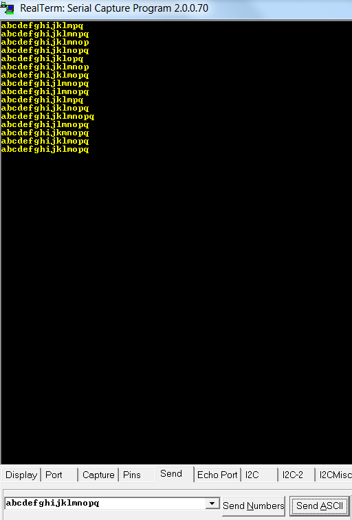

Currently I implemented a UART application on CC2541. Basically the application echoes what it receives from the UART Rx to the Tx pin at 115200 baud rate. But it encounters data lost.
 j
Shown above is one instance where "abcdefghijklmnopq" is sent from a PC to CC2541, and the yellow font characters are the reponse. You can notice a randomn lost of charaters.

After a careful examination, the event processing routine is called twice. The first call echoes "abcdefghijk", and the second call echoes "mnopq". It seemed that the receiving process is interrupted somehow. I checked the input data stream, there was no gaps between data bytes that was long enough to trigger an UART_IDLE_TIMEOUT. Therefore I wonder if there is anything that interrupts the UART receiving process?
