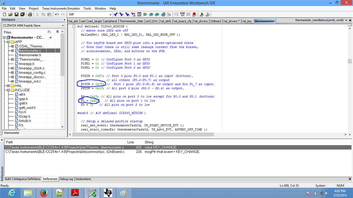

We have customized our PCB based on CC2541 and refers to keyfob schematic.  We relocate switch from P0.1 to P1.7, But unable to operate it. It was working well at P0.1 on keyfob but not at P1.7 on customized board.

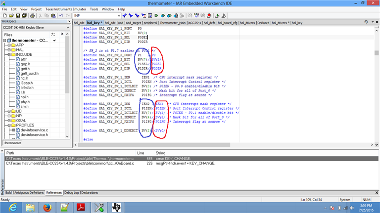

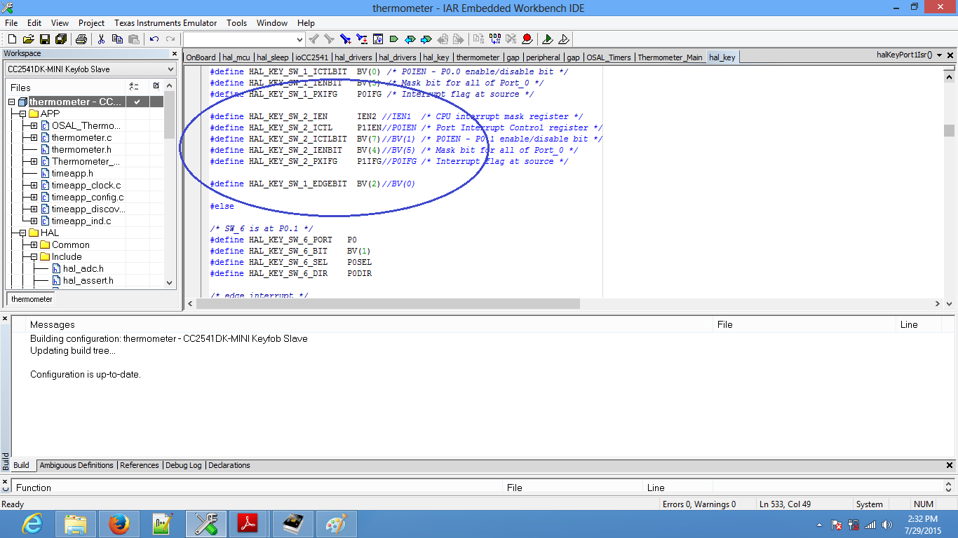

I have made the following changes in ,
1) hal_key.c ;
Note : current config is encircled in BLUE and earlier configuration in RED.

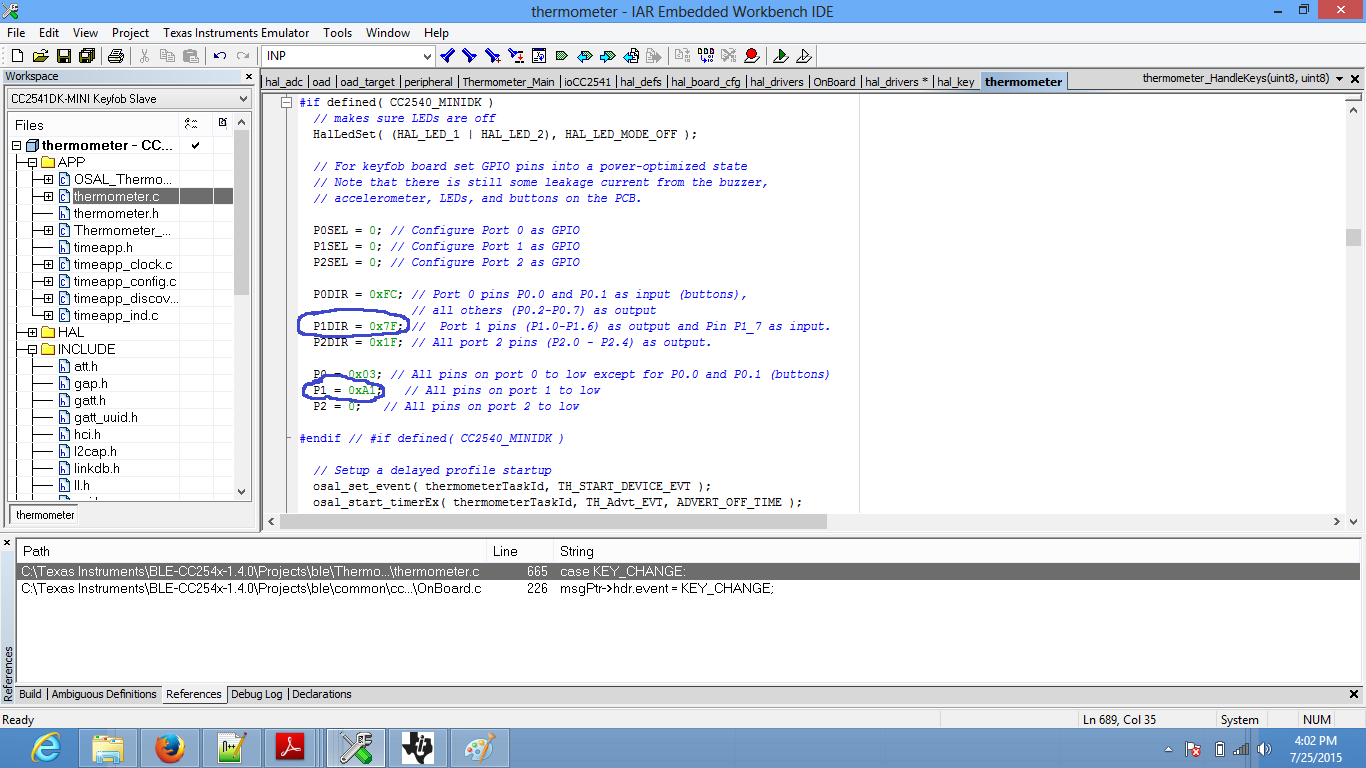

2) themometer.c
Note : Current config is encircled in BLUE.
I hope I made my point clear, if not please let me know what left.
Thanks in advance.

  • These registers seem correct. If you set a breakpoint in P1 ISR and press Switch P1.7, does it stop inISR?
  • When set a breakpoint at ISR and run debugger then it got stuck.Don't know why?

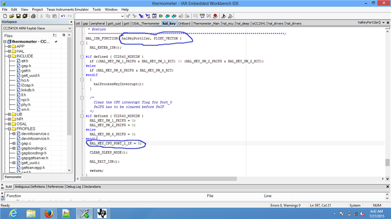

  • What do you mean get stuck? Can you show me your code of P1 ISR?
  • Here is the screenshot of the routine.

  • I mean that you should set a breakpoint at p1 ISR function in hal_key.c and check if it stops there.
  • Okey,Sorry I misunderstood it.
    I have placed a breakpoint there and it went inside the routine when switch is pressed.
  • That means your resisters settings are correct.

  • Can you attach your hal_key.c?
  • Please find below the hal_key.c,

  • Since you use P1.7 as input, why don't you implement HAL_ISR_FUNCTION( halKeyPort1Isr, P1INT_VECTOR )?
  • Now, changed the above suggested line of code but still not working.
  • Can you show how you modify HAL_ISR_FUNCTION( halKeyPort1Isr, P1INT_VECTOR )?
  • Here is the screenshot of HAL_ISR_FUNCTION, changes are encircled.

  • Yes, it seems your register settings are incorrect. Can you post your latest defines about HAL_KEY_SW_2_XXX?
  • Ok.Here are the screenshots of the definations,Please find them.
    SS1:
    SS2:
    SS3:
    Hopefully I have attach all definitions, If anything left, Please let me know.

    PICTL &= ~(HAL_KEY_SW_6_EDGEBIT); /* Clear the edge bit */
    /* For falling edge, the bit must be set. */
    #if (HAL_KEY_SW_6_EDGE == HAL_KEY_FALLING_EDGE)
    PICTL |= HAL_KEY_SW_6_EDGEBIT;
    #endif
    /* Interrupt configuration:
    * - Enable interrupt generation at the port
    * - Enable CPU interrupt
    * - Clear any pending interrupt
    HAL_KEY_SW_6_ICTL |= HAL_KEY_SW_6_ICTLBIT;
    HAL_KEY_SW_6_IEN |= HAL_KEY_SW_6_IENBIT;
    HAL_KEY_SW_6_PXIFG = ~(HAL_KEY_SW_6_BIT);
    /* Rising/Falling edge configuratinn */
    HAL_KEY_JOY_MOVE_ICTL &= ~(HAL_KEY_JOY_MOVE_EDGEBIT); /* Clear the edge bit */
    #if (HAL_KEY_JOY_MOVE_EDGE == HAL_KEY_FALLING_EDGE)
    HAL_KEY_JOY_MOVE_ICTL |= HAL_KEY_JOY_MOVE_EDGEBIT;
    #endif
    HAL_KEY_JOY_MOVE_ICTL |= HAL_KEY_JOY_MOVE_ICTLBIT;
    HAL_KEY_JOY_MOVE_IEN |= HAL_KEY_JOY_MOVE_IENBIT;
    HAL_KEY_JOY_MOVE_PXIFG = ~(HAL_KEY_JOY_MOVE_BIT);
    #endif // !CC2540_MINIDK
    /* Do this only after the hal_key is configured - to work with sleep stuff */
    if (HalKeyConfigured == TRUE)
    osal_stop_timerEx(Hal_TaskID, HAL_KEY_EVENT); /* Cancel polling if active */
    else /* Interrupts NOT enabled */
    #if defined ( CC2540_MINIDK )
    HAL_KEY_SW_1_ICTL &= ~(HAL_KEY_SW_1_ICTLBIT); /* don't generate interrupt */
    HAL_KEY_SW_2_ICTL &= ~(HAL_KEY_SW_2_ICTLBIT); /* don't generate interrupt */
    #else
    HAL_KEY_SW_6_ICTL &= ~(HAL_KEY_SW_6_ICTLBIT); /* don't generate interrupt */
    HAL_KEY_SW_6_IEN &= ~(HAL_KEY_SW_6_IENBIT); /* Clear interrupt enable bit */
    osal_set_event(Hal_TaskID, HAL_KEY_EVENT);
    /* Key now is configured */
    HalKeyConfigured = TRUE;
    HalKeyInit():
    void HalKeyInit( void )
    halKeySavedKeys = 0; // Initialize previous key to 0.
    HAL_KEY_SW_1_SEL &= ~(HAL_KEY_SW_1_BIT); /* Set pin function to GPIO */
    HAL_KEY_SW_1_DIR &= ~(HAL_KEY_SW_1_BIT); /* Set pin direction to Input */
    HAL_KEY_SW_2_SEL &= ~(HAL_KEY_SW_2_BIT); /* Set pin function to GPIO */
    HAL_KEY_SW_2_DIR &= ~(HAL_KEY_SW_2_BIT); /* Set pin direction to Input */
    #else
    HAL_KEY_SW_6_SEL &= ~(HAL_KEY_SW_6_BIT); /* Set pin function to GPIO */
    HAL_KEY_SW_6_DIR &= ~(HAL_KEY_SW_6_BIT); /* Set pin direction to Input */
    HAL_KEY_JOY_MOVE_SEL &= ~(HAL_KEY_JOY_MOVE_BIT); /* Set pin function to GPIO */
    HAL_KEY_JOY_MOVE_DIR &= ~(HAL_KEY_JOY_MOVE_BIT); /* Set pin direction to Input */
    P2INP |= PUSH2_BV; /* Configure GPIO tri-state. */
    #endif
    /* Initialize callback function */
    pHalKeyProcessFunction = NULL;
    /* Start with key is not configured */
    HalKeyConfigured = FALSE;
    PICTL |= HAL_KEY_SW_1_EDGEBIT; /* Set the edge bit to set falling edge to give int */
    HAL_KEY_SW_1_IEN |= ( HAL_KEY_SW_1_IENBIT | HAL_KEY_SW_2_IENBIT ); /* enable CPU interrupt */
    #endif
  • I don't see you set HAL_KEY_SW_2_IEN in HalKeyConfig(). Please add the following red line in your HalKeyConfig.
    void HalKeyConfig (bool interruptEnable, halKeyCBack_t cback)
    /* Enable/Disable Interrupt or */
    Hal_KeyIntEnable = interruptEnable;
    /* Register the callback fucntion */
    pHalKeyProcessFunction = cback;
    /* Determine if interrupt is enable or not */
    if (Hal_KeyIntEnable)
    HAL_KEY_SW_1_ICTL |= HAL_KEY_SW_1_ICTLBIT; /* enable interrupt generation at port */
    HAL_KEY_SW_1_PXIFG = ~(HAL_KEY_SW_1_BIT); /* Clear any pending interrupt */
    HAL_KEY_SW_2_ICTL |= HAL_KEY_SW_2_ICTLBIT; /* enable interrupt generation at port */
    HAL_KEY_SW_2_PXIFG = ~(HAL_KEY_SW_2_BIT); /* Clear any pending interrupt */
    HAL_KEY_SW_2_IEN |= HAL_KEY_SW_2_IENBIT;
  • By adding this line to configuration routine, made switch to work.
    Thanks a lot for your support and cooperation. It wouldn't be easy without your help.
    Thanks once again.
    Kumar Karan Jain
