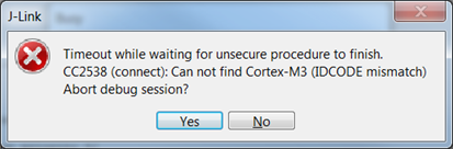

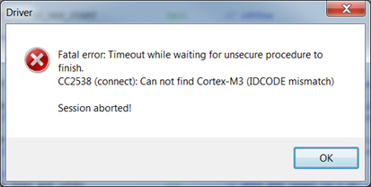

Problem with JTAG with J-link Ultra+ after update to stack 2.1
Other Parts Discussed in Thread: CC2640
I have update our custom board to stack 2.1 at first look all works, After the first flash-load of code build on 2.1 I am unable to connect to the target using J-link, SmartRF06 can still connect.
If a flash-load a “old” 2.0 version or just erases flash with SmarfRF06 a am able to load 1 time.
Is there somewhere JTAG is setup?
BR
Michael
The error msg from j-link is:
My appBLE.cfg is:

    I've notified our Tools department so they can assist you with this.
    Aslak
  • Hi Michael,
    The J-Link debuggers currently only have limited support for the CC26xx device family. In particular, the debugger will not handle very well situations where the chip enters low power states.
    For full debug support, we recommend using the TI XDS debuggers (XDS100v3/110/200) or IAR's iJet.
  • Michael,
    I suspect the reason for this is that the TI RTOS version that came with v2.0 did not force "soft resets" to become a full device reset.
    The only proper way to reset the CC26XX series is to pull the reset pin or use the SysCtrlSystemReset() API and then attach the debugger by toggling TCK (which makes the CPU halt before program code is executed)
    Some debuggers (probably also the J-link) writes to a Cortex M3 reset register instead which will in v2.1 cause a full chip reset (including the debug subsystem).
    Until J-Link implements the correct way of debugging the device you can do the following:
    - Make a copy of setup.c in C:\ti\tirtos_simplelink_2_13_00_06\products\cc26xxware_2_21_01_15600\driverlib and add it to your workspace. This will override the setup.c included in the linked-in driver library.
    - Comment out the following line:
    HWREGBITW( PRCM_BASE + PRCM_O_WARMRESET, PRCM_WARMRESET_WR_TO_PINRESET_BITN ) = 1;
    Note that you will see strange behavior now and then when debugging the device unless the full reset is done as only the MCU system is reset by the "soft resets", causing e.g. RTC and oscillator configuration to be configured from earlier code running on the device.
    Svend
  • Hello,  I also have a problem with j-link in stack 2.1. The stack 2.0 is no such problem.
    "- Comment out the following line:
    HWREGBITW( PRCM_BASE + PRCM_O_WARMRESET, PRCM_WARMRESET_WR_TO_PINRESET_BITN ) = 1;"   This steps did not solve the problem.
  • Katuxa,
    You need also to add that file into your workspace to override the version in the prebuilt driver library.
    Svend
  • Hi,katuxa
    do you resolve this Bad JTAG communication problem?
    I also get this error.
  • Hi, svendbt
    I add the C:\ti\tirtos_simplelink_2_13_00_06\products\cc26xxware_2_21_01_15600\driverlib\setup.c into my workspace ,and comment the code:
    But I also get the problem:Bad JTAG communication when I download the Bin to my cc2640 board .
  • Hi Timber Wolf.
    I didn't resolved this problem.
    Sorry, it took a bit before we had a chance to take a look at this (not that trivial) problem.
    Will be fixed in V5.02b which is going to be released within the next hour.
    www.segger.com/jlink-software.html
    Subscribe to the J-Link update notification list:
    www.segger.com/.../subscribe.php
    Best regards
    SEGGER J-Link Support
