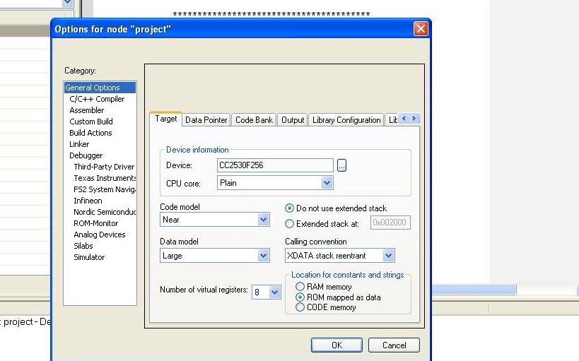

I'm trying to compile the BIM project on CC2541.. .but when compiling this error occurs...
Fatal Error[e72]: Segment BANKED_CODE must be defined in a segment definition option (-Z, -b or -P)

I finally get clean code with above settings of all error related to XDATA overflow issue and PBANK
redefination issue goes away.
