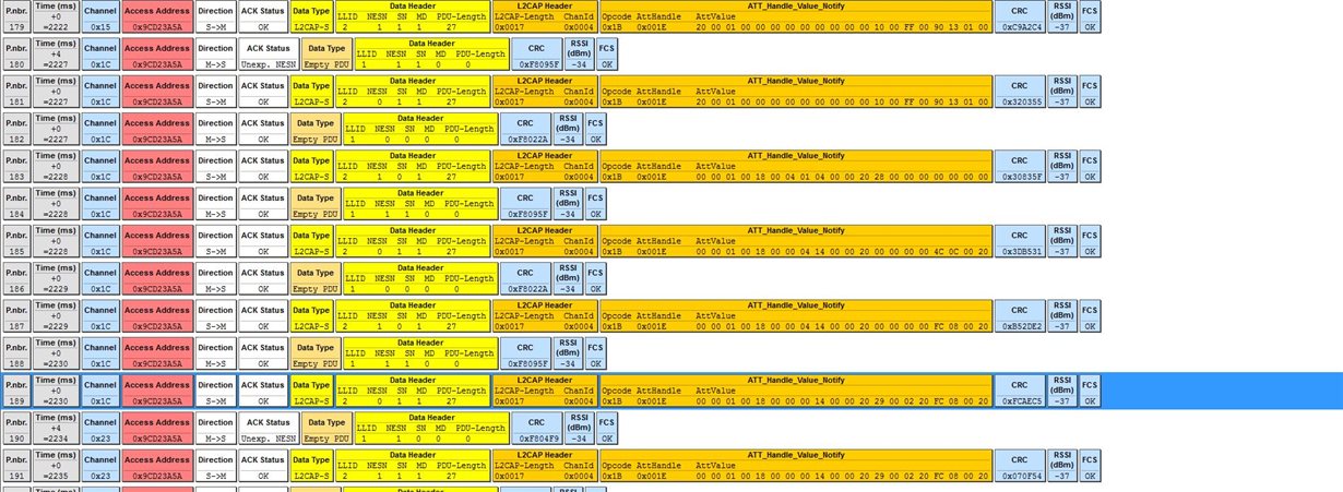

I followed the TI link to optimize the BLE Throughput : http://processors.wiki.ti.com/index.php/CC2640_BLE_Throughput

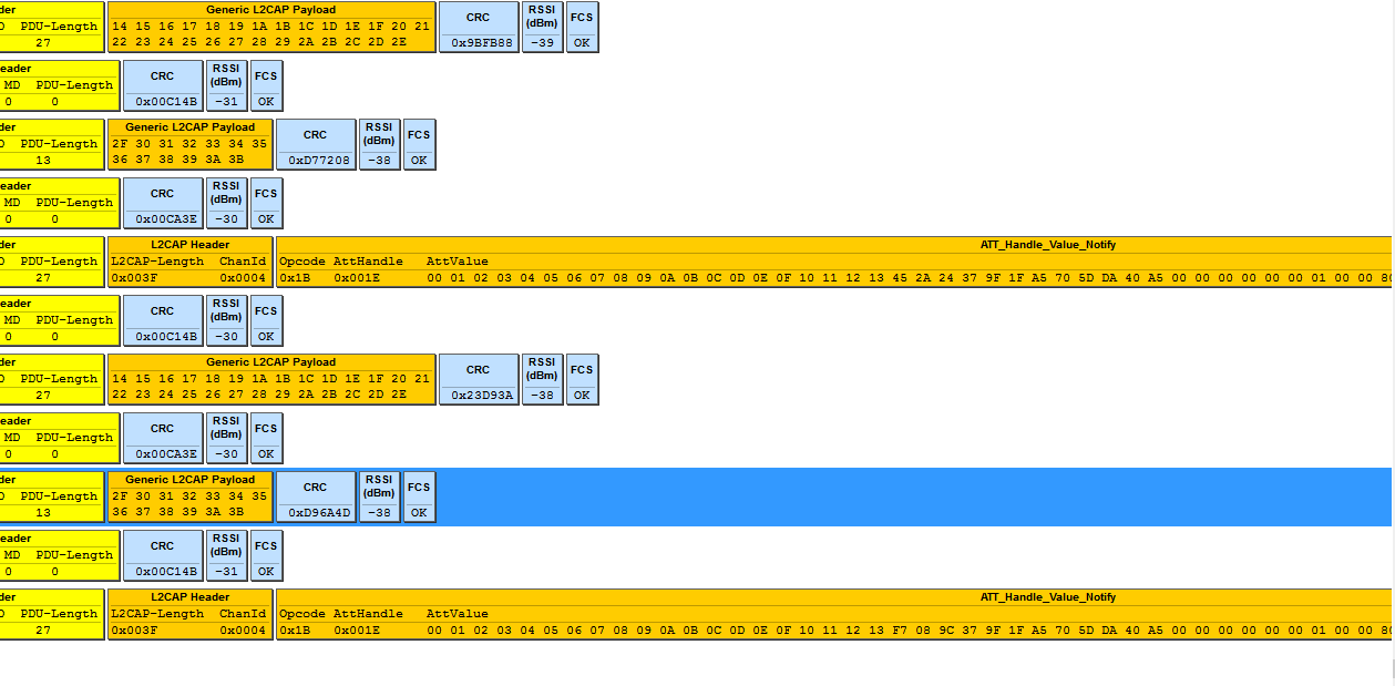

I obtained a characteristic with 60 bytes but when I try to change the transmitted values it looks like in the screenshot.
I created a for loop to put values from 0 to 59 in the characteristic but it  send in ATT_Handle_Value_Notify from 0 to 0x13, on the first payload from 0x14 to 0x2E and in the final payload from 0x2F to 0x3B. How can I change the characteristic to write all values in ATT_Handle_Value_Notify, not in payload?
P.S. In ATT_Handle_Value_Notify the rest of the values are random.

    It is not possible to send more than 20 bytes of data payload for notification as defined by the specification.

    So, you are saying that the ATT_Handle_Value_Notify is useless to be bigger? In this characteristic I have 60 bytes but I can't change values, it sends first 20 bytes with the data that I want and the rest of them are random bytes.

    I set the ATT_Handle_Value_Notify at 20 bytes and I want to transmit 8 packets in a 7.5 ms connection interval. I want to obtain something like
    1000 ms / 7.5 ms * 20 bytes * 8packets = 21333 bytes/sec = 170,666 bps. At this moment I am sending 5 packets which means 1000 ms / 7.5ms * 20bytes *5 packets = 13333bytes/sec = 106,666 bps.
    Here is a screenshot:
    As you can see the L2CAP Header is sent everytime with my data. Can I send the L2CAP Header only once in a connection interval?

    You can use a higher MAX_PDU_SIZE in your application(default is 27), and if both the peripheral and central side supports it, you should see L2CAP Header once for each notification.
