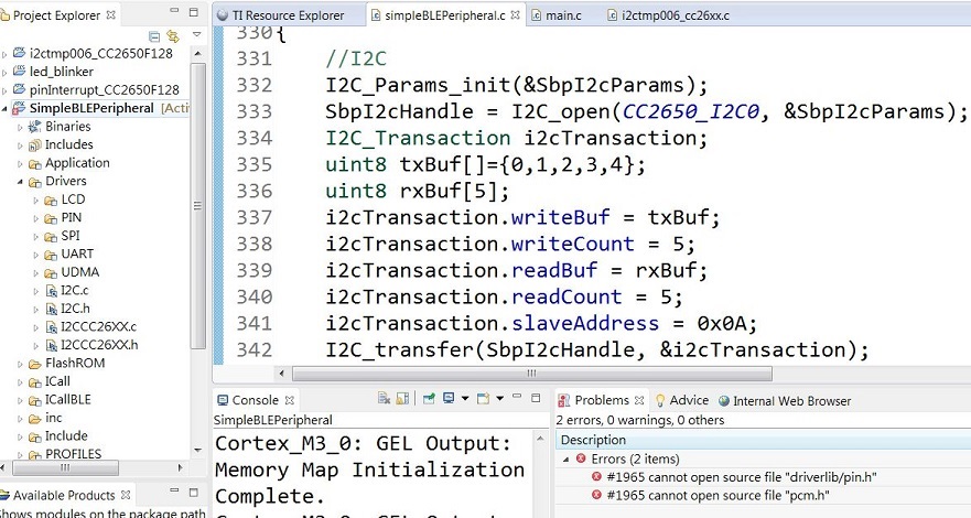

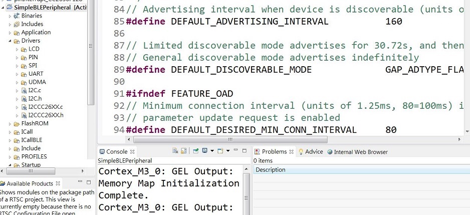

Hello:

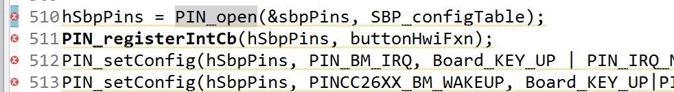

I am follow Developer's guide page 88 : 6.3.1 PIN , modify simpleBLEPeripheral.c:
step 3 always show error ?
#define DEFAULT_ADVERTISING_INTERVAL 160
#define DEFAULT_DISCOVERABLE_MODE GAP_ADTYPE_FLAGS_GENERAL
#ifndef FEATURE_OAD
#define DEFAULT_DESIRED_MIN_CONN_INTERVAL 80
#define DEFAULT_DESIRED_MAX_CONN_INTERVAL 800
#define DEFAULT_DESIRED_SLAVE_LATENCY 0
#define DEFAULT_DESIRED_CONN_TIMEOUT 1000
#define DEFAULT_ENABLE_UPDATE_REQUEST TRUE
#define DEFAULT_CONN_PAUSE_PERIPHERAL 6
#define SBP_PERIODIC_EVT_PERIOD 5000
// Task configuration
#define SBP_TASK_PRIORITY 1
// Internal Events for RTOS application
#define SBP_STATE_CHANGE_EVT 0x0001
#define SBP_CHAR_CHANGE_EVT 0x0002
#define SBP_PERIODIC_EVT 0x0004
#define SBP_CONN_EVT_END_EVT 0x0008
// App event passed from profiles.
typedef struct
appEvtHdr_t hdr;
} sbpEvt_t;
static PIN_Config SBP_configTable[]=
Board_LED1 | PIN_GPIO_OUTPUT_EN | PIN_GPIO_HIGH | PIN_PUSHPULL | PIN_DRVSTR_MAX,
Board_KEY_UP | PIN_INPUT_EN | PIN_PULLUP | PIN_IRQ_NEGEDGE,
PIN_TERMINATE
static PIN_State sbpPins;
static PIN_Handle hSbpPins;
static buttonCallbackFxn(PIN_Handle nPin, PIN_Id pinId)
uint32_t currVal = 0;
if (!PIN_getInputValue(pinId)){
switch (pinId){
case Board_KEY_UP:
currVal = PIN_getOutputValue(Board_LED1);
PIN_setOutputValue(hSbpPins, Board_LED1, !currVal);
break;
default:
break;

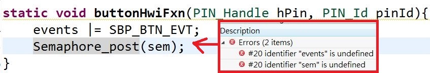

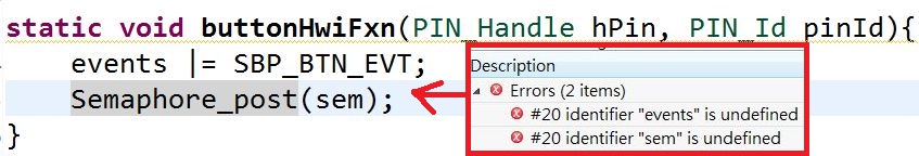

static void buttonHwiFxn(PIN_Handle hPin, PIN_Id pinId){
events |= SBP_BTN_EVT;
Semaphore_post(sem);
Hello YiKai :
How strange . In this code , I found another events .
static void SimpleBLEPeripheral_clockHandler(UArg arg){
// Store the event.
events |= arg;
//Wake up the application.
building succeed ?
Try to use my revised simpleBLEPeripheral.c.

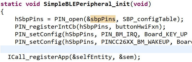

Hello Yikai :
Your code is working without error
but I try to follow SWRU393A chapter 6.3.1 PIN Step 4 :
SimpleBLEPeripheral_taskFxn(UArg a0, UArg a1)
// Initialize application
SimpleBLEPeripheral_init();
if (events & SBP_BTN_EVT)
events &= ~SBP_BTN_EVT;
if(LED_value){
PIN_setOutputValue(hSbpPins, Board_LED1 , LED_value--);
}else{
PIN_setOutputValue(hSbpPins, Board_LED1, LED_value++);
will show identifier "LED_value" is undefined

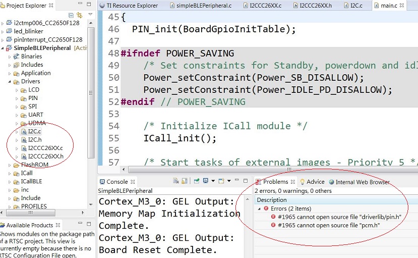

and Step 5 : In SimpleBLEPeripheral_init()

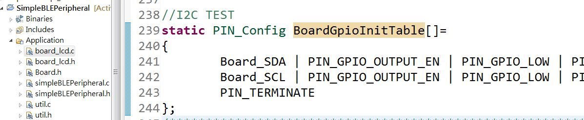

Hello Yikai:
So I need to edit Board.c file :
C:\ti\tirtos_simplelink_2_13_00_06\packages\ti\boards\SRF06EB\CC2650EM_7ID
PIN_Config BoardGpioInitTable[] = {
Board_SDA | PIN_GPIO_OUTPUT_EN | PIN_GPIO_LOW | PIN_PUSHPULL | PIN_DRVSTR_MAX,
Board_SCL | PIN_GPIO_OUTPUT_EN | PIN_GPIO_LOW | PIN_PUSHPULL | PIN_DRVSTR_MAX,
Board_LED3 | PIN_GPIO_OUTPUT_EN | PIN_GPIO_LOW | PIN_PUSHPULL | PIN_DRVSTR_MAX,
Board_LED4 | PIN_GPIO_OUTPUT_EN | PIN_GPIO_LOW | PIN_PUSHPULL | PIN_DRVSTR_MAX
PIN_TERMINATE /* Terminate list */
#include <ti/drivers/I2C/I2CCC26XX.h>
I2CCC26XX_Object i2cCC26XXObjects[CC2650_I2CCOUNT];
const I2CCC26XX_HWAttrs i2cCC26XXHWAttrs[CC2650_I2CCOUNT] = {
.baseAddr = I2C0_BASE,
.intNum = INT_I2C,
.powerMngrId = PERIPH_I2C0,
.sdaPin = Board_SDA,
.sclPin = Board_SCL
---------------OK----------------

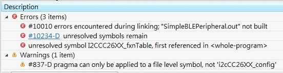

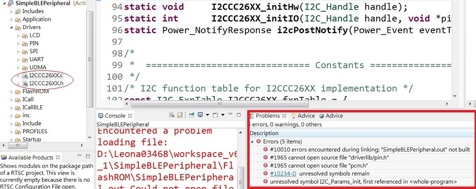

but If I add this line :
const I2C_Config I2C_config[] = {
{ &I2CCC26XX_fxnTable, &i2cCC26XXObjects[0], &i2cCC26XXHWAttrs[0] },
{ NULL, NULL, NULL}
building error....

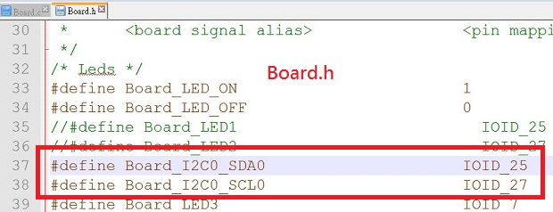

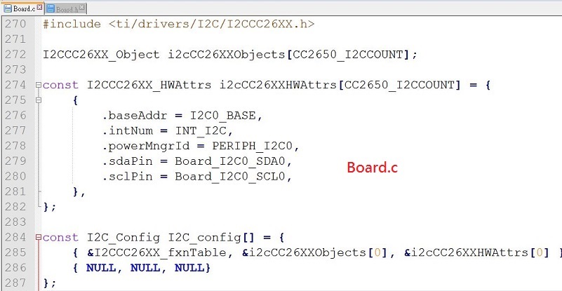

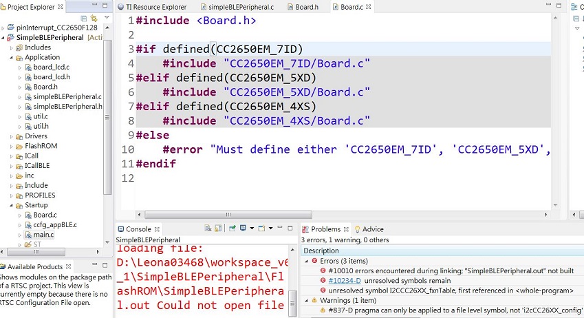

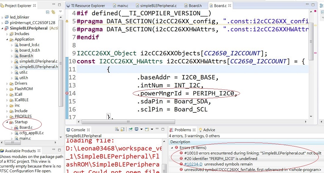

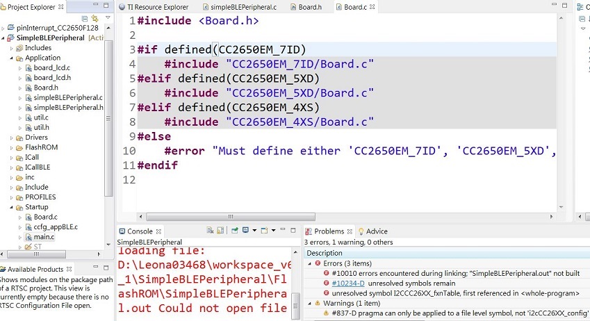

Hello Yikai:
I edit Board.c file:
It's not building succeed when I add this line :
{ NULL, NULL, NULL}
Board.h
/* Leds */
#define Board_LED_ON 1 /* LEDs on CC2650 are active high */
#define Board_LED_OFF 0
#define Board_LED1 IOID_25 /* RF2.11 */
#define Board_LED2 IOID_27 /* RF2.13 */
#define Board_LED3 IOID_7 /* RF1.2 */
#define Board_LED4 IOID_6 /* RF1.4 */
/* I2C */
#define Board_I2C0_SDA0 IOID_25
#define Board_I2C0_SCL0 IOID_27
Board.c
.intNum = INT_I2C,
.sdaPin = Board_I2C0_SDA0,
.sclPin = Board_I2C0_SCL0,
{ NULL, NULL, NULL}
I attach my Board.h and Board.c. You can replace the one in C:\ti\tirtos_simplelink_2_13_00_06\packages\ti\boards\SRF06EB\CC2650EM_7ID and build again.
/* * Copyright (c) 2015, Texas Instruments Incorporated * All rights reserved. * * Redistribution and use in source and binary forms, with or without * modification, are permitted provided that the following conditions * are met: * * * Redistributions of source code must retain the above copyright * notice, this list of conditions and the following disclaimer. * * * Redistributions in binary form must reproduce the above copyright * notice, this list of conditions and the following disclaimer in the * documentation and/or other materials provided with the distribution. * * * Neither the name of Texas Instruments Incorporated nor the names of * its contributors may be used to endorse or promote products derived * from this software without specific prior written permission. * * THIS SOFTWARE IS PROVIDED BY THE COPYRIGHT HOLDERS AND CONTRIBUTORS "AS IS" * AND ANY EXPRESS OR IMPLIED WARRANTIES, INCLUDING, BUT NOT LIMITED TO, * THE IMPLIED WARRANTIES OF MERCHANTABILITY AND FITNESS FOR A PARTICULAR * PURPOSE ARE DISCLAIMED. IN NO EVENT SHALL THE COPYRIGHT OWNER OR * CONTRIBUTORS BE LIABLE FOR ANY DIRECT, INDIRECT, INCIDENTAL, SPECIAL, * EXEMPLARY, OR CONSEQUENTIAL DAMAGES (INCLUDING, BUT NOT LIMITED TO, * PROCUREMENT OF SUBSTITUTE GOODS OR SERVICES; LOSS OF USE, DATA, OR PROFITS; * OR BUSINESS INTERRUPTION) HOWEVER CAUSED AND ON ANY THEORY OF LIABILITY, * WHETHER IN CONTRACT, STRICT LIABILITY, OR TORT (INCLUDING NEGLIGENCE OR * OTHERWISE) ARISING IN ANY WAY OUT OF THE USE OF THIS SOFTWARE, * EVEN IF ADVISED OF THE POSSIBILITY OF SUCH DAMAGE. */ /* * ====================== Board.c ============================================= * This file is responsible for setting up the board specific items for the * SRF06EB with the CC2650EM_7ID board. */ /* * ====================== Includes ============================================ */ #include <inc/hw_memmap.h> #include <inc/hw_ints.h> #include <driverlib/ioc.h> #include <driverlib/udma.h> #include <xdc/std.h> #include <xdc/runtime/System.h> #include <ti/sysbios/family/arm/m3/Hwi.h> #include <ti/sysbios/family/arm/cc26xx/Power.h> #include <ti/sysbios/family/arm/cc26xx/PowerCC2650.h> #include <ti/drivers/PIN.h> #include "Board.h" /* Include drivers */ #include <ti/drivers/i2c/I2CCC26XX.h> /* * ========================= IO driver initialization ========================= * From main, PIN_init(BoardGpioInitTable) should be called to setup safe * settings for this board. * When a pin is allocated and then de-allocated, it will revert to the state * configured in this table. */ PIN_Config BoardGpioInitTable[] = { Board_LED1 | PIN_GPIO_OUTPUT_EN | PIN_GPIO_LOW | PIN_PUSHPULL | PIN_DRVSTR_MAX, /* LED initially off */ Board_LED2 | PIN_GPIO_OUTPUT_EN | PIN_GPIO_LOW | PIN_PUSHPULL | PIN_DRVSTR_MAX, /* LED initially off */ Board_LED3 | PIN_GPIO_OUTPUT_EN | PIN_GPIO_LOW | PIN_PUSHPULL | PIN_DRVSTR_MAX, /* LED initially off */ Board_LED4 | PIN_GPIO_OUTPUT_EN | PIN_GPIO_LOW | PIN_PUSHPULL | PIN_DRVSTR_MAX, /* LED initially off */ Board_KEY_SELECT | PIN_INPUT_EN | PIN_PULLUP | PIN_HYSTERESIS, /* Button is active low */ Board_KEY_UP | PIN_INPUT_EN | PIN_PULLUP | PIN_HYSTERESIS, /* Button is active low */ Board_KEY_DOWN | PIN_INPUT_EN | PIN_PULLUP | PIN_HYSTERESIS, /* Button is active low */ Board_KEY_LEFT | PIN_INPUT_EN | PIN_PULLUP | PIN_HYSTERESIS, /* Button is active low */ Board_KEY_RIGHT | PIN_INPUT_EN | PIN_PULLUP | PIN_HYSTERESIS, /* Button is active low */ Board_3V3_EN | PIN_GPIO_OUTPUT_EN | PIN_GPIO_LOW | PIN_PUSHPULL, /* 3V3 domain off initially */ Board_LCD_MODE | PIN_GPIO_OUTPUT_EN | PIN_GPIO_HIGH | PIN_PUSHPULL, /* LCD pin high initially */ Board_LCD_RST | PIN_GPIO_OUTPUT_EN | PIN_GPIO_HIGH | PIN_PUSHPULL, /* LCD pin high initially */ Board_LCD_CSN | PIN_GPIO_OUTPUT_EN | PIN_GPIO_HIGH | PIN_PUSHPULL, /* LCD pin high initially */ Board_UART_TX | PIN_GPIO_OUTPUT_EN | PIN_GPIO_HIGH | PIN_PUSHPULL, /* UART TX pin at inactive level */ PIN_TERMINATE /* Terminate list */ }; /*============================================================================*/ /* * ============================= UART begin =================================== */ #if defined(__TI_COMPILER_VERSION__) #pragma DATA_SECTION(UART_config, ".const:UART_config") #pragma DATA_SECTION(uartCC26XXHWAttrs, ".const:uartCC26XXHWAttrs") #endif /* Include drivers */ #include <ti/drivers/UART.h> #include <ti/drivers/uart/UARTCC26XX.h> /* UART objects */ UARTCC26XX_Object uartCC26XXObjects[CC2650_UARTCOUNT]; /* UART hardware parameter structure, also used to assign UART pins */ const UARTCC26XX_HWAttrs uartCC26XXHWAttrs[CC2650_UARTCOUNT] = { { /* CC2650_UART0 */ .baseAddr = UART0_BASE, .intNum = INT_UART0, .powerMngrId = PERIPH_UART0, .txPin = Board_UART_TX, .rxPin = Board_UART_RX, .ctsPin = PIN_UNASSIGNED, .rtsPin = PIN_UNASSIGNED }, }; /* UART configuration structure */ const UART_Config UART_config[] = { { &UARTCC26XX_fxnTable, &uartCC26XXObjects[0], &uartCC26XXHWAttrs[0] }, { NULL, NULL, NULL } }; /* * ============================= UART end ===================================== */ /* I2C objects */ I2CCC26XX_Object i2cCC26xxObjects[CC2650_I2CCOUNT]; /* I2C configuration structure, describing which pins are to be used */ const I2CCC26XX_HWAttrs i2cCC26xxHWAttrs[CC2650_I2CCOUNT] = { { .baseAddr = I2C0_BASE, .intNum = INT_I2C, .powerMngrId = PERIPH_I2C0, .sdaPin = Board_I2C0_SDA0, .sclPin = Board_I2C0_SCL0, } }; const I2C_Config I2C_config[] = { {&I2CCC26XX_fxnTable, &i2cCC26xxObjects[0], &i2cCC26xxHWAttrs[0]}, {NULL, NULL, NULL} }; /* * ============================= UDMA begin =================================== */ /* Place into subsections to allow the TI linker to remove items properly */ #if defined(__TI_COMPILER_VERSION__) #pragma DATA_SECTION(UDMACC26XX_config, ".const:UDMACC26XX_config") #pragma DATA_SECTION(udmaHWAttrs, ".const:udmaHWAttrs") #endif /* Include drivers */ #include <ti/drivers/dma/UDMACC26XX.h> /* UDMA objects */ UDMACC26XX_Object UdmaObjects[CC2650_UDMACOUNT]; /* UDMA configuration structure */ const UDMACC26XX_HWAttrs udmaHWAttrs[CC2650_UDMACOUNT] = { { UDMA0_BASE, INT_UDMAERR, PERIPH_UDMA }, }; /* UDMA configuration structure */ const UDMACC26XX_Config UDMACC26XX_config[] = { {&UdmaObjects[0], &udmaHWAttrs[0]}, {NULL, NULL}, }; /* * ============================= UDMA end ===================================== */ /* * ========================== SPI DMA begin =================================== */ /* Place into subsections to allow the TI linker to remove items properly */ #if defined(__TI_COMPILER_VERSION__) #pragma DATA_SECTION(SPI_config, ".const:SPI_config") #pragma DATA_SECTION(spiCC26XXDMAHWAttrs, ".const:spiCC26XXDMAHWAttrs") #endif /* Include drivers */ #include <ti/drivers/spi/SPICC26XXDMA.h> /* SPI objects */ SPICC26XX_Object spiCC26XXDMAObjects[CC2650_SPICOUNT]; /* SPI configuration structure, describing which pins are to be used */ const SPICC26XX_HWAttrs spiCC26XXDMAHWAttrs[CC2650_SPICOUNT] = { { /* SRF06EB_CC2650_SPI0 */ .baseAddr = SSI0_BASE, .intNum = INT_SSI0, .defaultTxBufValue = 0, .powerMngrId = PERIPH_SSI0, .rxChannelBitMask = 1<<UDMA_CHAN_SSI0_RX, .txChannelBitMask = 1<<UDMA_CHAN_SSI0_TX, .mosiPin = Board_SPI0_MOSI, .misoPin = Board_SPI0_MISO, .clkPin = Board_SPI0_CLK, .csnPin = Board_SPI0_CSN }, { /* SRF06EB_CC2650_SPI1 */ .baseAddr = SSI1_BASE, .intNum = INT_SSI1, .defaultTxBufValue = 0, .powerMngrId = PERIPH_SSI1, .rxChannelBitMask = 1<<UDMA_CHAN_SSI1_RX, .txChannelBitMask = 1<<UDMA_CHAN_SSI1_TX, .mosiPin = Board_SPI1_MOSI, .misoPin = Board_SPI1_MISO, .clkPin = Board_SPI1_CLK, .csnPin = Board_SPI1_CSN } }; /* SPI configuration structure */ const SPI_Config SPI_config[] = { /* SRF06EB_CC2650_SPI0 */ {&SPICC26XXDMA_fxnTable, &spiCC26XXDMAObjects[0], &spiCC26XXDMAHWAttrs[0]}, /* SRF06EB_CC2650_SPI1 */ {&SPICC26XXDMA_fxnTable, &spiCC26XXDMAObjects[1], &spiCC26XXDMAHWAttrs[1]}, {NULL, NULL, NULL}, }; /* * ========================== SPI DMA end ===================================== */ /* * ========================== LCD begin ======================================= */ /* Place into subsections to allow the TI linker to remove items properly */ #if defined(__TI_COMPILER_VERSION__) #pragma DATA_SECTION(LCD_config, ".const:LCD_config") #pragma DATA_SECTION(lcdHWAttrs, ".const:lcdHWAttrs") #endif /* Include drivers */ #include <ti/drivers/lcd/LCDDogm1286.h> /* LCD object */ LCD_Object lcdObject; /* LCD hardware attribute structure */ const LCD_HWAttrs lcdHWAttrs = { .LCD_initCmd = &LCD_initCmd, .lcdResetPin = Board_LCD_RST, /* LCD reset pin */ .lcdModePin = Board_LCD_MODE, /* LCD mode pin */ .lcdCsnPin = Board_LCD_CSN, /* LCD CSn pin */ .spiIndex = Board_SPI0 }; /* LCD configuration structure */ const LCD_Config LCD_config = {&lcdObject, &lcdHWAttrs}; /* * ========================== LCD end ========================================= */ /* * ========================== Crypto begin ======================================= * NOTE: The Crypto implementaion should be considered experimental and not validated! */ /* Place into subsections to allow the TI linker to remove items properly */ #if defined(__TI_COMPILER_VERSION__) #pragma DATA_SECTION(CryptoCC26XX_config, ".const:CryptoCC26XX_config") #pragma DATA_SECTION(cryptoCC26XXHWAttrs, ".const:cryptoCC26XXHWAttrs") #endif /* Include drivers */ #include <ti/drivers/crypto/CryptoCC26XX.h> /* Crypto objects */ CryptoCC26XX_Object cryptoCC26XXObjects[CC2650_CRYPTOCOUNT]; /* Crypto configuration structure, describing which pins are to be used */ const CryptoCC26XX_HWAttrs cryptoCC26XXHWAttrs[CC2650_CRYPTOCOUNT] = { {CRYPTO_BASE, INT_CRYPTO, PERIPH_CRYPTO} }; /* Crypto configuration structure */ const CryptoCC26XX_Config CryptoCC26XX_config[] = { {&cryptoCC26XXObjects[0], &cryptoCC26XXHWAttrs[0]}, {NULL, NULL} }; /* * ========================== Crypto end ========================================= */

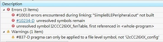

I try to new import
C:\ti\simplelink\ble_cc26xx_2_01_00_44423\Projects\ble\SimpleBLEPeripheral\CC26xx\CCS\SimpleBLEPeripheral
And building again , it's still not working.
In fact , I remove SimpleBLEPeripheral project and C:\ti\simplelink , tirtos_simplelink_2_13_00_06
then I rebuilding project , It's OK , no any error messages . By the way , LCD also can display messages.
Thank you very much .

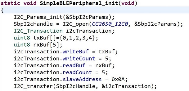

And one question , If I want to see I2C write / read on LCD , how can I do ? I know LCD_WRITE_STRING() , but don't know how to display messages on LCD .
Because even building is success , I can't see any result . According to Software Develope's Guide Chapter 6.3.4 Step 5 :
Compile, download, and run. This will perform a 5-byte I2C write / read.
5-byte ? where ?
Hello Yikai:
I see , at least I know I2C basic define . I import i2ctmp006 project and see step , I know it's project for SensorTag , I don't have SensorTag, but
I have this :
I define TMP006's SCL is DIO_6 and TMP006's SDA is DIO_5
