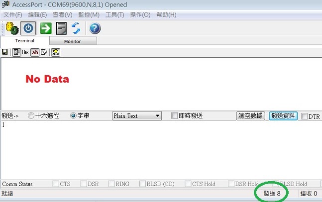

I want to know if I running project uartecho_CC2650F128 ,
Can I see any messages from my PC , I want to see data use this software:
Thank you.
  • Yes, you will see "Echoing characters:" on PC UART terminal console if you connect it to your PC.
  • Hello Yikai:
    Thank you . It' really can working if I use serial port to read / write data .

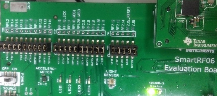

    but I have one question , that code define
    UART TX is IDIO_2 //RF1.7
    UART RX is IDIO_3 //RF1.9
    where is RF1.7 and RF1.9 , I can't find it on SmartRF06DK board ?
  • You can refer to SmartRF06EB user guide (www.ti.com/.../swru321a.pdf). RF1.7 and RF1.9 are on P412 which should be on right-bottom corner of SmatRF06EB.
  • I find it . Thank you.
  • You are welcome.

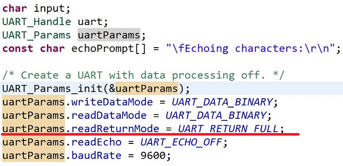

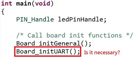

  • Hello Yikai:
    I run project "uartecho_CC2650F128" , there is a echoFxn :
    readReturnMode = UART_RETURN_FULL means what type key in , it's will return type?
    UART_write means I type one String "1" , UART_read will read String "1" ?
    Thank you.
  • 1. readReturnMode can be set to UART_RETURN_FULL or UART_RETURN_NEWLINE. UART_RETURN_FULL unblocks or performs a callback when the read buffer has been filled. UART_RETURN_NEWLINE unblocks or performs a callback whenever a newline character has been received.
    2. When you type a char on UART terminal, UART_read will receive that char.
    3. Yes, Board_initUART is necessary.

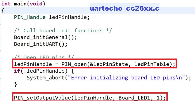

    ledPinHandle = PIN_open(&ledPins, ledPinsTable);
    PIN_setOutputValue(ledPinHandle, Board_LED1, 1);    //It's not work?
