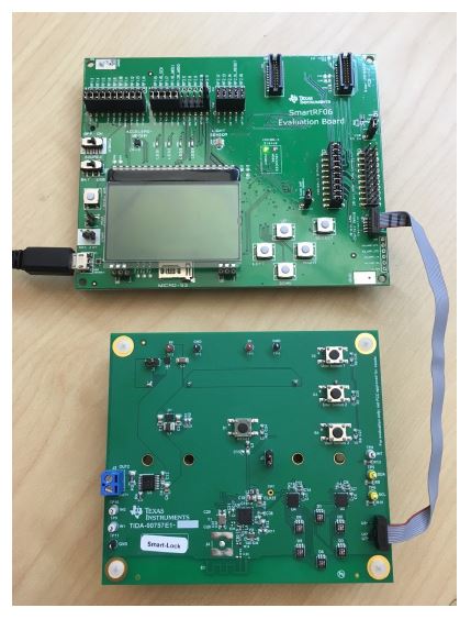

    Yes, I double checked all the cJTAG (not JTAG) signal connections and they are correct as recommended by the SmartRF06 User Guide Figure 24 (see attached file: cJTAG connections).
    For cJTAG, I've connected the following signals:
    1) VDD_SENSE (3.3V from my board), JTAG_TMS, JTAG_TCK, RESET, and GND from SmartRF06 EB P410 (10-pin ARM Cortex Debug Header) to my board.
    The jumper settings on SmartRF06 are:
    1) P408 - all jumpers are ON (connected)
    2) J503 - jumper on mounted (using VDD on my board)
    I made the cJTAG connection between SmartRF06 EB to my board via the 10-pin flat cable provided with the SmartRF06 EB (see attached file for connection diagram: cJTAG setup pic)
    I power the SmartRF06 first, then my board with the CC2640 device.
    I run/open the Flash Programmer 2 software.  It shows the XDS100v3 is detected.  Below XDS100v3 it shows Unknown device (see attached pic: FlashProgram2 Open).
    When I click on the "Unknown" icon below XDS100v3, it shows "selected device could not be indentified."
    If everything is working properly, below XDS100v3 it should show the CC2640 device instead of "Unknown".
    Does XDS100v3 support cJTAG?  I am assuming it does because I'm following the exact directions from the TIDA-00757 users manual (TIDUBV3A) pages 36 to 37.  TIDA-00757 reference design uses the same device that I'm using, the CC2640.
    Please let me know if I am doing something incorrect.
    Thanks!
    Chao
  • Hi Fredrik,
    I was able to detect and connect to the CC2640 device on my board using Flash Programmer 2 now.  I am able to flash the device with .hex file!
    Thanks for your help.
    Chao

    Was it just because the debug cable was connected the wrong way on the SmartRF06EB?
    Cheers,
