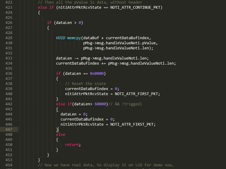

I follow ancs porting guider form ti wiki,Poring the ANCS to CC2640R2,  it‘s running ok. can recive the
information from iphone,like MissedCall,IncomingCall,Social Apps,But stress testing,there are three issues:
1)  social apps information about per 2 sencode.CC2640R2  will not recieve the information from iphone
2) Alternately turn on or off Bluetooth setting. CC2640R2 will can not bonded sucess with iphone.
3)  Alternately turn on or off Bluetooth setting. CC2640R2 will not advisting.
4) Delete the bond snv message. iphone keep the ltk information. when turn on the bluetooth setting.
    May occur many diffrent issue:1, CC2640R2 CRASH 2,CC2640R2 no advisting ever untill reset.3,keep connect with iphone,but no notify.
   Can Stack tell app  error LTK event ? the app can reject the connect request then advisting again.
ps: i test iphone 7plus,iphone 6,iphone 6s iphone 5s.ipad mini. ios version 10.2.1 and 10.3.1
