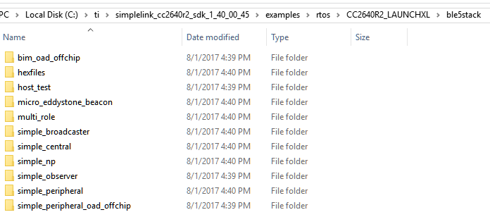

  • Hello.
    I'm looking into the long-range mode (or 125kbps coded Tx mode) myself. I wanted to give this 'long range demo' a try, but could not find it in the example folders of the 1.35 nor 1.40 stack.
    Also, the example code for simple-ble-peripheral includes some ifdefed-out code for enabling coded transmission.

  • Hi Koby,
    You can find the Long Range Demo on github: github.com/.../master
    If you want to use simple_peripheral, you should enable long range in the build_config.opt file (in the stack project). You don't have to define BLE_V50_FEATURES & PHY_LR_CFG anywhere else.
  • Thank you. Will give that a try.
