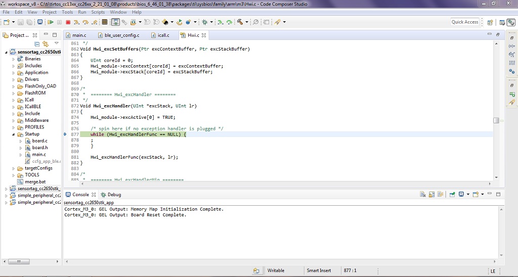

I am using the CC2650stk SensorTag2 with Code composer studio. While debugging the Sesnortag_app project it is getting stuck at exception handler on  hwi_exchandler every time. I am followed  the
CC26x0 SimpleLink™ Bluetooth® low energy Software Stack 2.2.x Developer's Guide and check all the points, but still, the problem exists.
In the above image, you can see where it is getting stuck.

    Do you remember to program the STACK?
    I was able to reproduce what you are seeing if I deliberately not program the stack while debugging.
    You need to program stack into CC2650 and the program/debug app.
    BTW, this sensortag is made for offchip_OAD configuration, which means you need to also program bim_extflash project(under examples/util folder) when you are not in debug mode.
