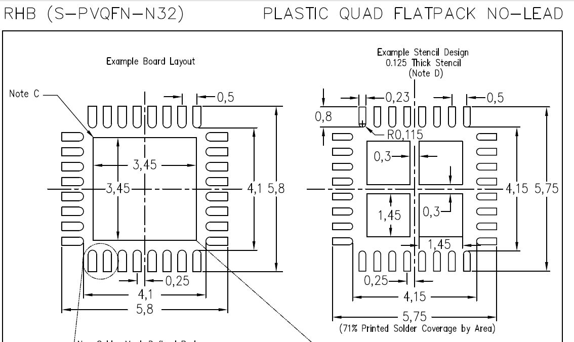

1. What is the best way to solder CC2640R2F RHB (5x5) chip to the PCB? Dots or Squares?
The layout shows this:
But the example stencil design (on the right) shows this pattern:
2. Is the PCB that is soldered to the chip connected to GND, Veb or is it separated (not connected to any other part of the PCB)?
