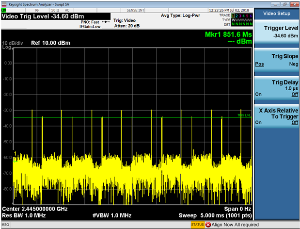

<CC2640 waveform in 2440 MHz>
Spectrum Analyzer Setting:
Center Frequency=2440MHz, Span=0MHz, RBW=1MHz
<CC2540 waveform in 2440 MHz>
Center Frequncy=2440MHz, Span=0MHz, RBW=1MHz
<CC2640 waveform in 2445 MHz>
Center Frequency=2445MHz, Span=0MHz, RBW=1MHz
The level is not flat during TX.
The rising edge level is quite higher than the other.
The falling edge level is quite higher than the other.
Is it no problem?
In Cc2640, Bluetooth SIG's In-Band Emission is very few margin.
M-N=3 : margin=1dB, M-N=-3 : margin=2dB
Is it no problem?
