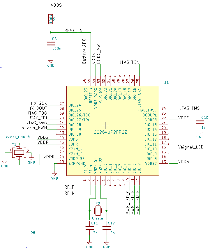

I am using CC2640R2 for a BLE application. My application is running fine on the CC2640R2 Launchpad, but on my custom PCB I see several problems. I use the launchpad as programmer and disconnected all the JTAG and power jumpers, to connect my custom application. The XDS Power jumper is removed. The software is a slightly modified Project_Zero. The pinout is very similar to the one of Project Zero, only that I do not have an SPI flash on board.
First of all, I need 2 retries for programming the firmware until programming is performed. CCS console:

After starting the program, I can reach BIOS_start(), but then breakpoints at the beginning of my tasks are not reached, and the next manual stop is in a Hardfault HWI with the following exception details:
Decoded exception,
Decoded,Hard Fault: FORCED: BUSFAULT: PRECISERR.Data Access Error. Address = 0x400c8000

When I look at the memory map I can find AUX Semaphores at the bus fault address 0x400c8000. Further investigation is difficult, as the executed code seems to be in the ROM part and I cannot resolve the symbols.
The exact same firmware works on the launchpad and I cannot see a reason why an access to the AUX modules occures only on my custom pcb.
Is there any way to debug this error further into the ROM? The exact same error seems to be described in post  .
Only that the solution given there does not apply to my situation because I am not porting from cc2650.
Does anyone have a clue what is going on in my device?
