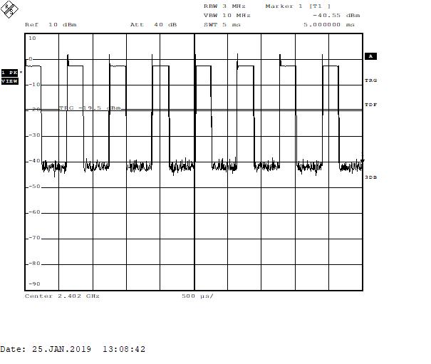

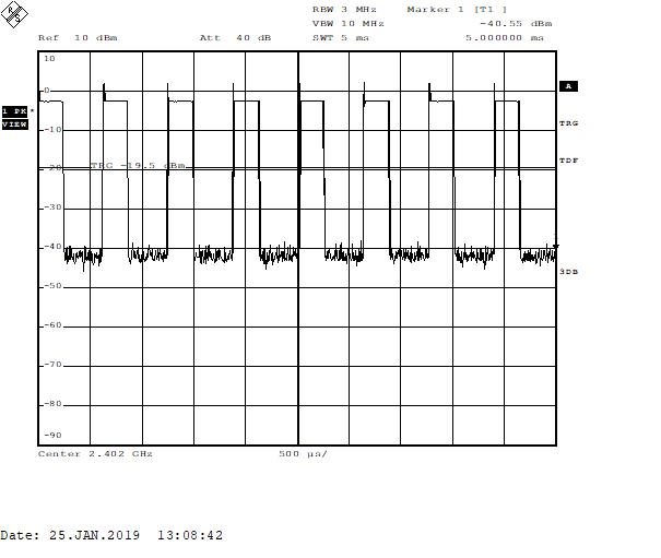

  • Hello
    Please see the attached image.
    We found a spike signal for every consecutive waveform.
    We just used the test command with the guideline. Please let us know if we can remove the spike.

  • Hi Sejin,
    According to what you posted before you are supposed to measure the average power. Does the spike matter?

  • Hi Sejin,
    I belive what you are seeing is just a little overshoot from the PA turning on.
    Fredrik

  • Hi Sejin,
    It is common and it is not a problem. Our evaluation boards all pass the most common regulatory limits with margins.
    Fredrik
