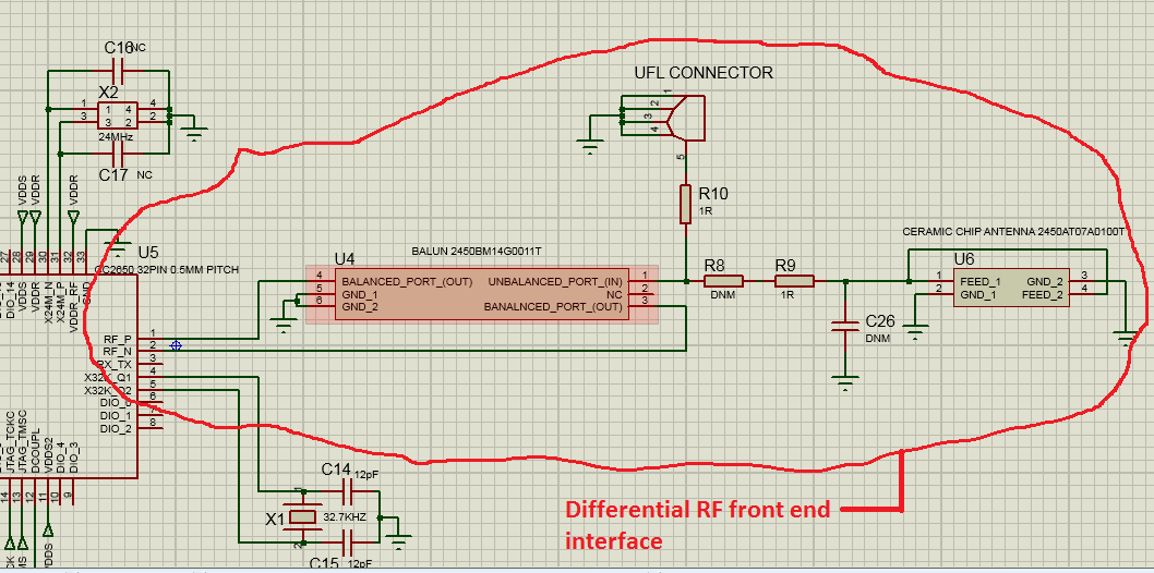

CC2650: CC2650 diferential RF front end interface verification
Part Number: CC2650
We have successfully developed cc2650 custom board with inverted F antenna and matching circuit using inductor,capacitor and resistor as given in cc2650EM design note.
Now we have made some changes in matching circuit and in antenna.We have used BALUN 2450BM14G0011T for matching 50ohm and 2450AT07A0100T chip antenna.I am attaching circuit image.Please tell us is there need any changes in schematic.We using balun and chip antenna in differential rf front end interface type.
