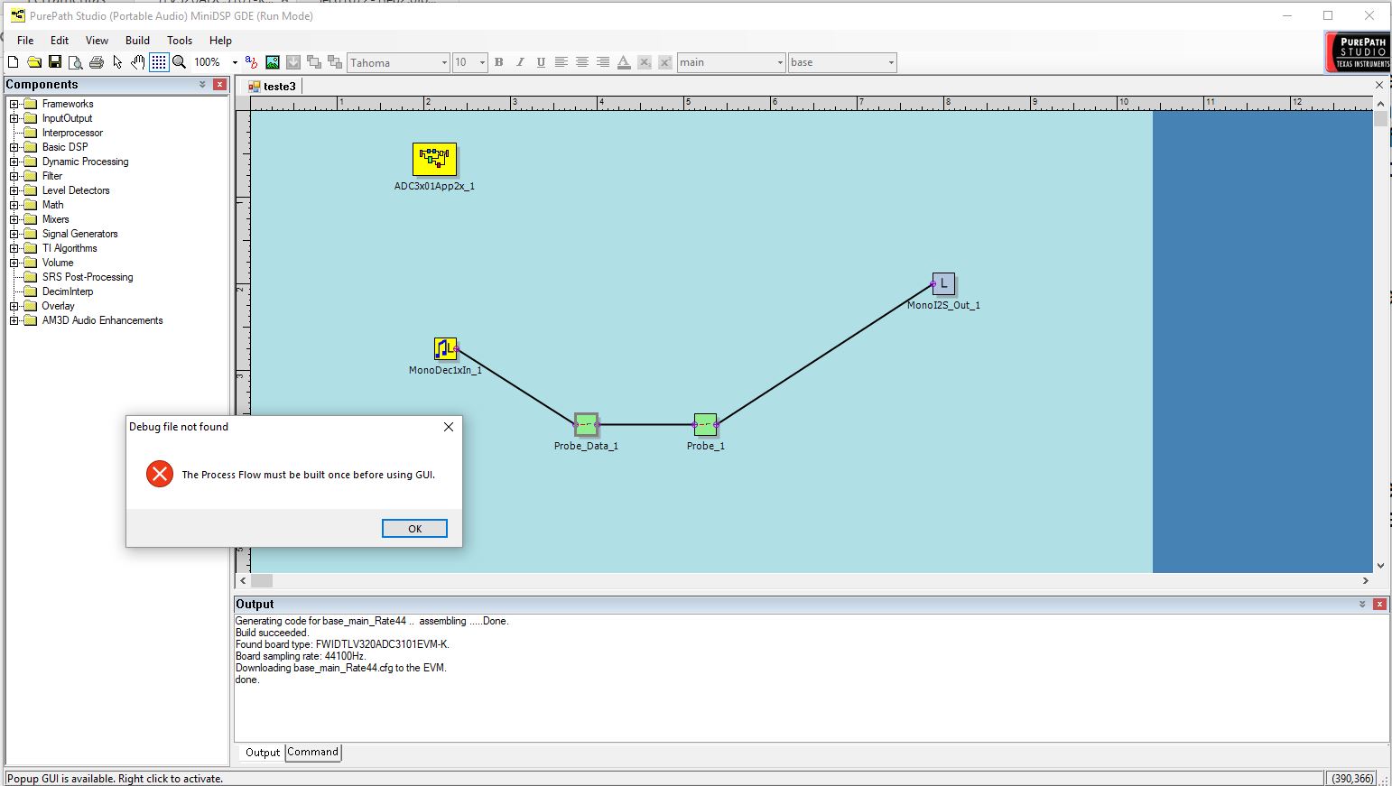

    In the meantime I bought a kit MODEVM+TLV320ADC3101, connected it to PPS and succeded in mounting block diagrams and compile them.
    But I didn't find documentation on how to deal with the component Probe of PPS. When I drag and drop Probe, Probe-Data or Probe-Coef, in the Diagram Window of PPS, run the compilation and try to open Probe window through the debug probe point, there is no signal listed and it appears an option to load a prb file (attached picture).
    Would you kindly send an example or documentation about Probe components?

  • Hi Diljith,
    PurePath Studio version is 5.95 build 1 revision 35815 Component Library Version 6738.
    I used the Insert file option to attach the pfw file, but as this format is not allowed to be attached, I changed its extension to txt, please rename it to pfw.
    Before and after compiling , if I try to open Probe Data GUI, the following message appears:

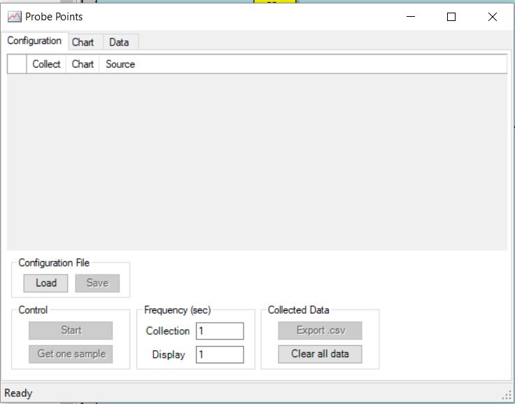

    If I try to open the debug probe point, the Probe Points window is the following:

  • Hi Newton,
    Probing memories in run-time is not supported on ADC3x01 devices using this component. The probe component requires the DSP to support adaptive coefficient memory. Adaptive mode enables the coefficient banks to be switched on-the-fly between host and dsp access. Without adaptive mode the host cannot access the memory while the DSP is running. On these devices, memories can be read after turning off the DSP.
