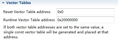

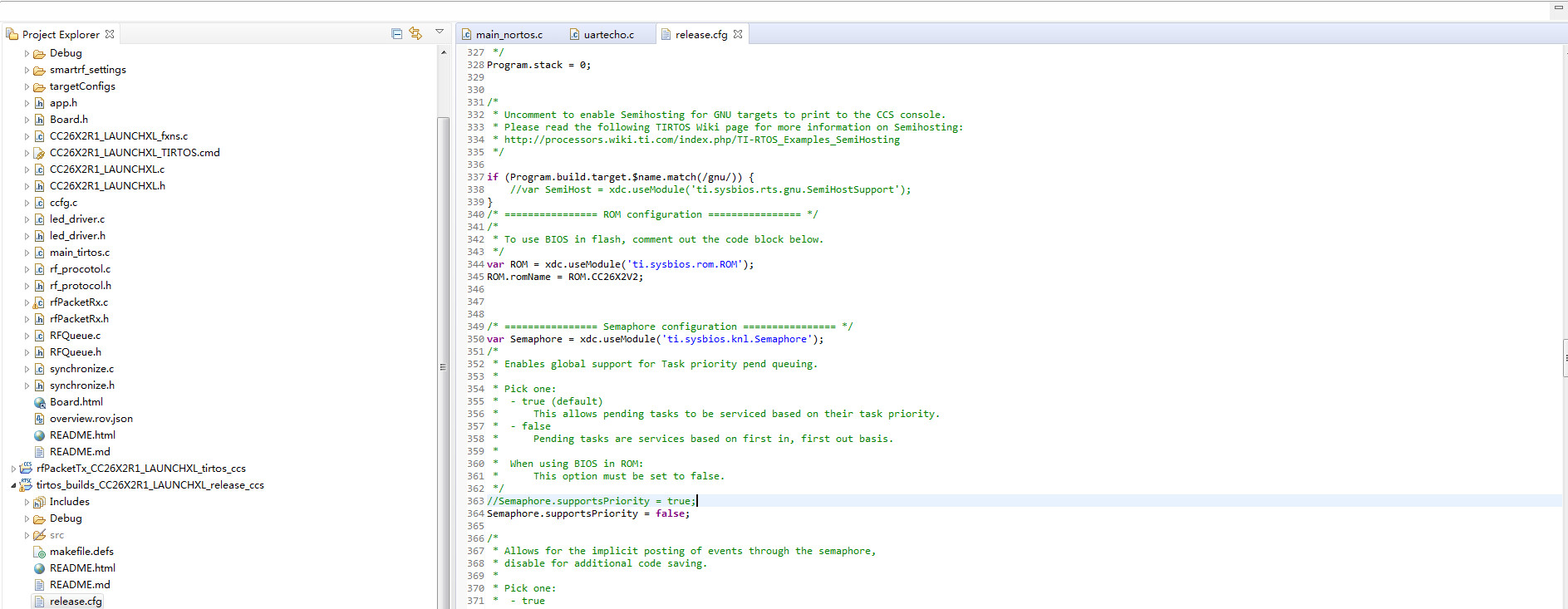

we bulid a customer bootloader for cc26x2, bootloader address: 0x0000~0x3FFF, and our application code address start from 0x4000.
what should we change the the ccfg.c and the cfg file to make sure it works?
i mean how can we change the "resetVectorAddress" to 0x4000(application start address)?
i know how to do this about CC26X0,but failed on CC26x2.

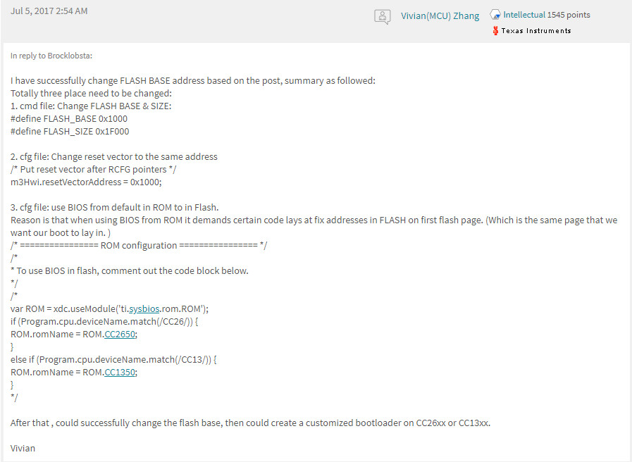

could TI tell us how to do this like this:
https://e2e.ti.com/support/wireless-connectivity/sub-1-ghz/f/156/p/605674/2232249?tisearch=e2e-sitesearch&keymatch=%2525252525252520user%252525252525253A291339#2232249
