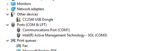

Hi need your help regarding below issue Device not detected
Hi Imran,
Did you connect the USB cable between your PC and the SmartRF05EB? Please refer to this related thread: https://e2e.ti.com/support/wireless-connectivity/bluetooth/f/538/t/423253
Alexis
Try to install attached driver.
Do you download CC2540_USBdongle_HostTestRelease_All.hex into your CC2540 USB dongle?
You can find CC2540_USBdongle_HostTestRelease_All.hex at C:\Texas Instruments\BLE-CC254x-1.5.0.16\Accessories\HexFiles if you install BLE Stack 1.5.0 and you can refer to CC2540 USB Evaluation Kit Quick Start Guide to download CC2540_USBdongle_HostTestRelease_All.hex to your CC2540 USB dongle. I also attach my CC2540_USBdongle_HostTestRelease_All.hex for your reference.
