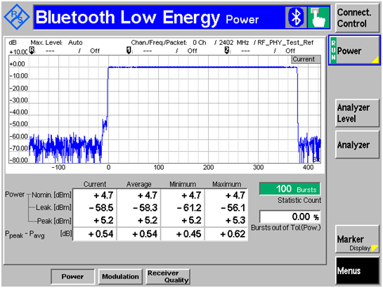

Using Rohde & Schwarz CBT Bluetooth Tester with CC254xEM Running HostTestRelease
This section describes setup of CC2540EM/CC2541EM for Bluetooth low energy RF testing using Rohde & Schwarz CBT Bluetooth Tester.
The RS232 port on the SmartRF05EB can be used to connect to the Bluetooth low energy tester.
===Setup of SmartRF05EB===
  1. Set switch “EM selection” (P19) to Soc/TRX.
  2. Set switch “RS232 Enable” (P14) to Enable.
The RS232 driver charge pump generates noise that is coupled into the supply to the CC2540/CC2541. Therefore it is a good idea to separate power supply to the EM to avoid this:
  1. Remove jumper on P15 (V_EM)
  2. Insert positive supply to pin 2 on P15, and supply ground to pin GND on P3.
Setting up CC254x for PHY Testing
Use hex image: C:\Texas Instruments\BLE-CC254x-1.2\Accessories\HexFiles\CC2540_SmartRF_HostTestRelease_All.hex or CC2541_SmartRF_HostTestRelease_All.hex Use Flash Programmer to program the EM device hosting the SmartRF05EB by
  1. Attach the SmartRF05EB with a USB cable to the PC.
  2. Install SmartRF flash programmer (SmartRF flash programmer 1.11.1 or newer)
    1. Select the correct flash image and push “Perform action” button. Ensure that “Erase, program and verify” is selected.
    Downloading from IAR is also possible by using the HostTestRelease project (found at C:\Texas Instruments\BLE-CC254x-1.2\Projects\ble\HostTestApp\CC254X\HostTestRelease.eww)
    Select CC254XEM project and select “Project” -> “Download and debug” (or press Ctrl+D).
    Rohde & Schwarz CBT
    Option CBT-K57 Bluetooth low energy wireless technology option must be installed.
    HCI/RS232 Setup
    Setup HCI connection for stand-alone operation:
    *System (Button sub group) -> Setup (Hard button) -> Comm.(Soft button) ->
      • Application -> DUT Control
      • Baudrate -> 115200 (or 57600)
      • Databits -> 8
      • Stop bits -> 1
      • Parity -> None
      • Protocol -> None
    Connect to EM
    • “Connect. Ctrl” (Upper right soft button)
    • “Enable Test mode” (Soft button)
    Test with output power measurements
    Menu select (soft button) -> Bluetooth LE Power (soft button) -> Power (soft button)
     Rohde & Schwarz screen shot from output power test.
