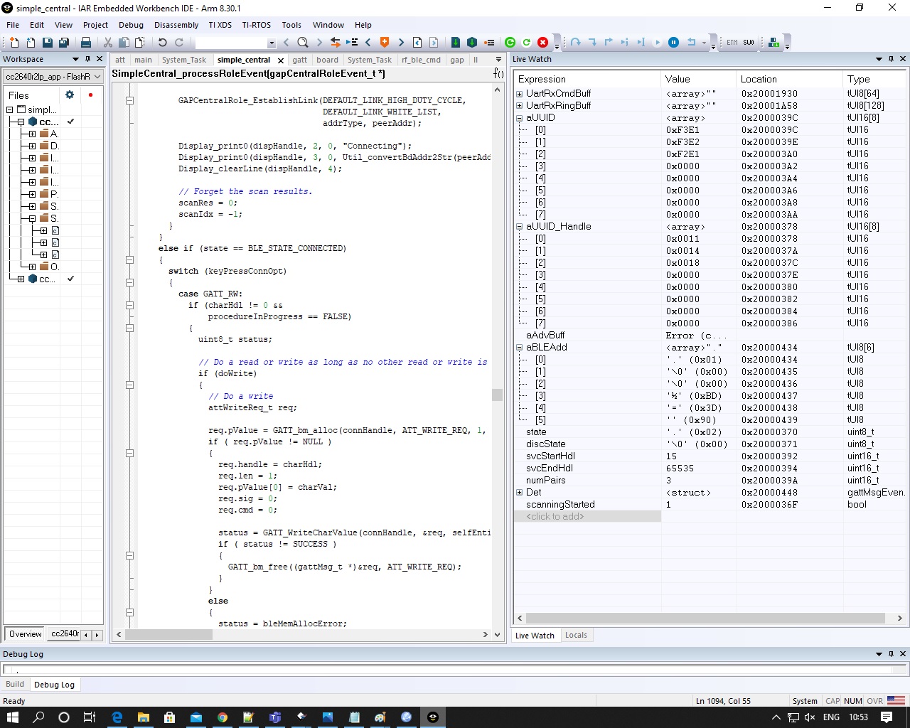

  • Also num pairs value is coming 3 when device is getting connected and svc start handle and svc end handle are 0x0015 and 0xFFFF.
    Now when i fix the start handle and end handle as 0x0001 and 0xFFFF numpairs value comes 5 but UUID and handle are not getting discovered correctly.

    The above code snippet defines my characteristic discovery with their respective handles.
    1. Num pairs signifies the number of UUID and their respective handles.
    2. When i pass the svc start handle and end handle discovered , then  num pairs value is coming 3 and I am able to discover all those 3 but total there are 5 characteristics within this service.
    3. At the same time when I fix the svc start and end handle as 0x0001 and 0xFFFF then num pairs gets updated to 5 but none of the characteristics gets discovered. In both the cases the connection gets established.
    Sudhanshu
  • Hi Sudhanshu,
    If you connect to this device using host_test + BTool, what does your service + characteristic hierarchy look like? Does the discovery function properly? And does it look correct there? Feel free to include a screenshot of that as well.
