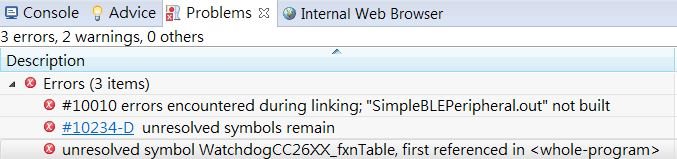

  • Hello svendbt:
    just a problem , when I add
    const Watchdog_Config Watchdog_config[] = {
     { &WatchdogCC26XX_fxnTable, &watchdogCC26XXObjects[0], &watchdogCC26XXHwAttrs[0] },
     { NULL, NULL, NULL },
    into Board.c
    I get error messages:
  • You need to include the driver file
    /* Include drivers */
    #include <ti/drivers/watchdog/WatchdogCC26XX.h>
  • Hello Christin :
    I also add #include <ti/drivers/watchdog/WatchdogCC26XX.h> in Board.c
    Board.c path :
    C:\ti\tirtos_simplelink_2_13_00_06\packages\ti\boards\SRF06EB\CC2650EM_7ID\Board.c
