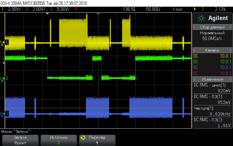

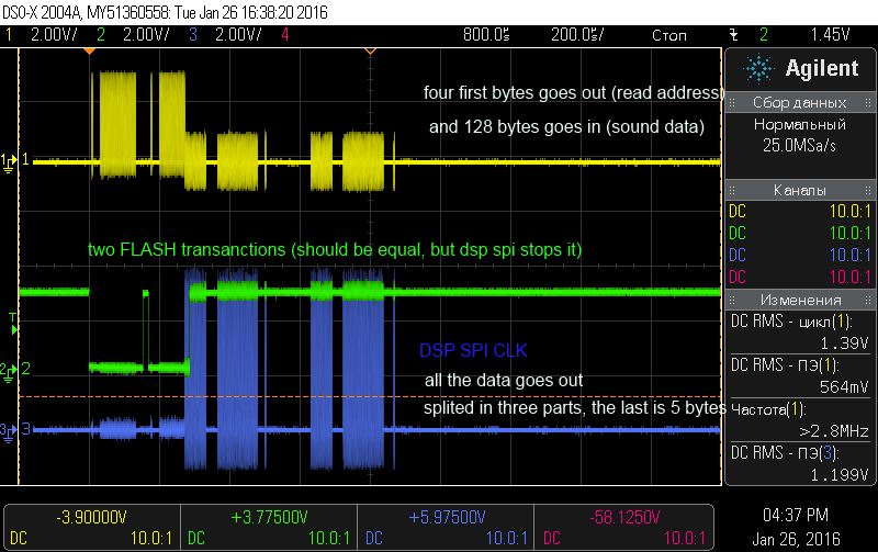

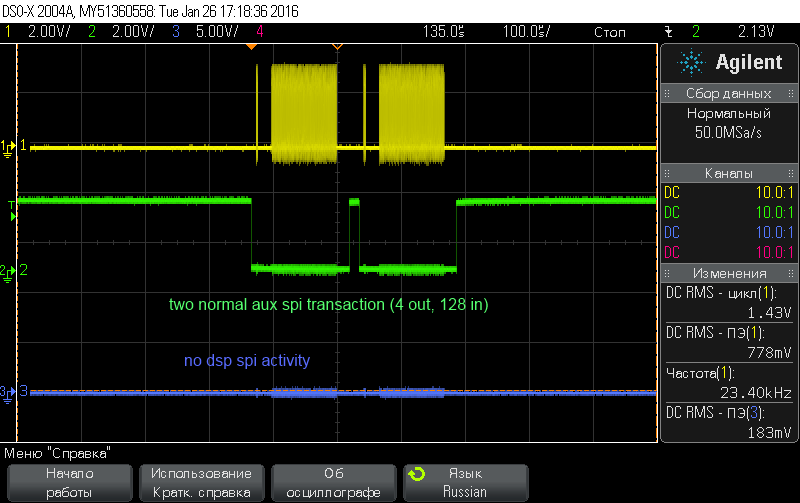

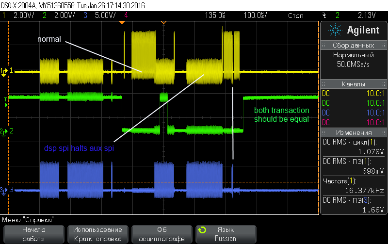

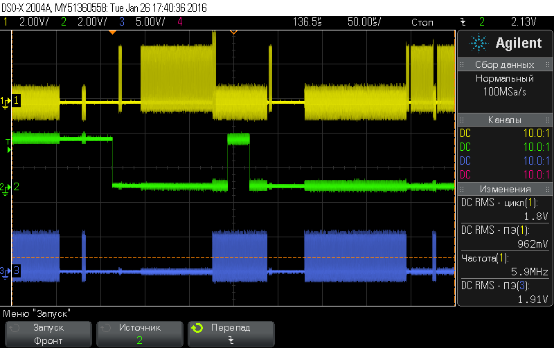

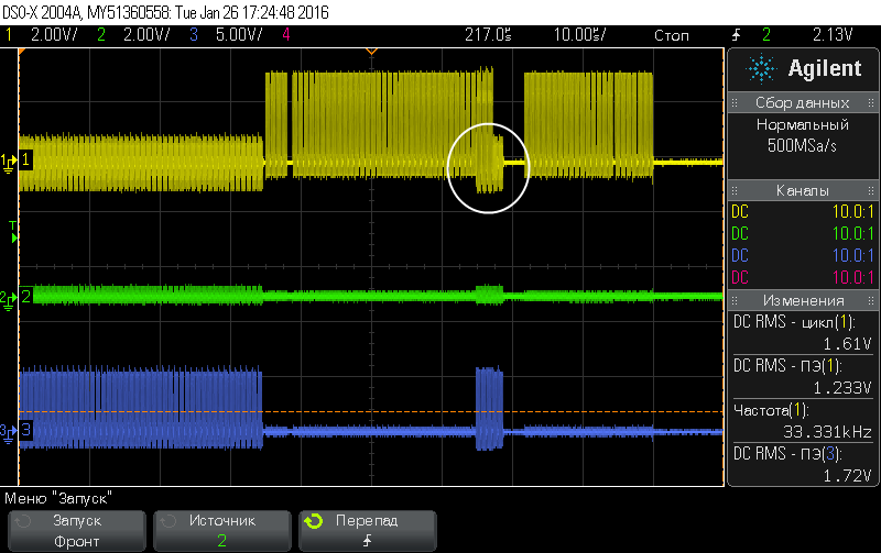

I'm trying to use TWO SPI simultaneously in CC2640: one for read/write external spi - FLASH, and other one is for shifting data to the shift register. The oscilloscope observation shows that SPI-transfer when started simultaneously on both channels actually is not simultaneously and occurring in time - shared manner.
Is it possible to achieve truly simultaneously transmitting/receiving via SPI ? Both SPI use two independent DMA-channels.
