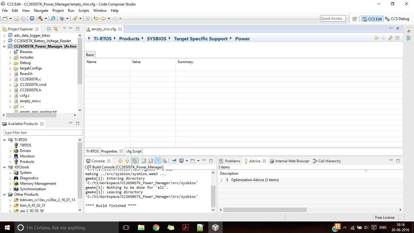

    After making this We tested above code to make current consumption measurements. We found following results. I have attached screenshot for power consumption below. My measurements are -->> it is consuming 8 mA current when LED is in OFF state an 11 mA when LED is in ON state.
    So, my question is why there is very high current consumption when LED is in OFF state (8mA). It should be very low like in the range of micro-Amps is we are applying power policy. I think we are unable to implement power policy properly.
    Please let me know elaboreate solution if I am making any mistakes.

  • In that link provided I can not go to the screenshot 1. I have attached my system screenshot.

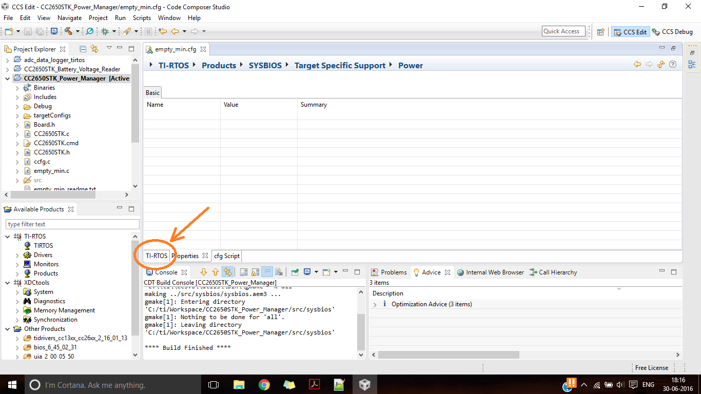

    Ah, yes, the pictures only show up when logged in to a 43oh forum account.
    If you click on the TI-RTOS tab (just above the console view in your screenshot) you should get a page with a checkbox "Invoke Power Policy function when all threads are blocked". Uncheck that, and go to the BIOS Overview page (TI-RTOS > Products > SYSBIOS > BIOS - System Overview) and click on the "Idle" box in the threads area. That should take you to the page where you can set up the custom idle task.
    With that set up as described in the 43oh thread you'll be able to put a breakpoint in the idle task and easily see whether it's being run as expected.
  • Hi Robert,
    I really did not understand your reply. I tried to find out that checkbox option for "Invoke Power Policy function when all threads are blocked".
    But could not find it neither I understood your comment :- Ah, yes, the pictures only show up when logged in to a 43oh forum account.
    Can you please elaborate your reply so that I will be able to find out that checkbox?
  • Jayesh Sarode said:
    [...] neither I understood your comment :- Ah, yes, the pictures only show up when logged in to a 43oh forum account.
    The post I linked to on 43oh.com has pictures embedded, but you can only see them if you're a member of that forum. Non-members only get to see the text without any pictures.
    Can you post another screenshot showing what happens if you click on the TI-RTOS tab marked on the image below:
  • If I click on TI-RTOS tab, it takes me to the homepage. I did not understand what is 43oh.com and how it is associated with CCS.
    Screenshot attached:-

    // #include <ti/drivers/Watchdog.h>
    /* Board Header files */
    #include "Board.h"
    /* Power Management Header Files */
    #include <ti/drivers/Power.h>
    #include <ti/drivers/power/PowerCC26XX.h>
    //#include <ti/sysbios/family/arm/cc26xx/Power.h>
    #define TASKSTACKSIZE   512
    Task_Struct task0Struct;
    Char task0Stack[TASKSTACKSIZE];
    /* Pin driver handle */
    static PIN_Handle ledPinHandle;
    static PIN_State ledPinState;
     * Application LED pin configuration table:
     *   - All LEDs board LEDs are off.
    PIN_Config ledPinTable[] = {
        Board_LED0 | PIN_GPIO_OUTPUT_EN | PIN_GPIO_LOW | PIN_PUSHPULL | PIN_DRVSTR_MAX,
        Board_LED1 | PIN_GPIO_OUTPUT_EN | PIN_GPIO_LOW | PIN_PUSHPULL | PIN_DRVSTR_MAX,
        PIN_TERMINATE
    void myIdleFunc(){
    	System_printf("Idle loop running\n");
    	PowerCC26XX_standbyPolicy();
     *  ======== heartBeatFxn ========
     *  Toggle the Board_LED0. The Task_sleep is determined by arg0 which
     *  is configured for the heartBeat Task instance.
    Void heartBeatFxn(UArg arg0, UArg arg1)
        while (1) {
            Task_sleep((UInt)arg0); // Want sensortag to be in deep sleep mode
            PIN_setOutputValue(ledPinHandle, Board_LED0,
                               !PIN_getOutputValue(Board_LED0));
     *  ======== main ========
    int main(void)
    	Power_enablePolicy();
        Task_Params taskParams;
        /* Call board init functions */
        Board_initGeneral();
        // Board_initI2C();
        // Board_initSPI();
        // Board_initUART();
        // Board_initWatchdog();
        /* Construct heartBeat Task  thread */
        Task_Params_init(&taskParams);
        taskParams.arg0 = 10000;
        taskParams.stackSize = TASKSTACKSIZE;
        taskParams.stack = &task0Stack;
        Task_construct(&task0Struct, (Task_FuncPtr)heartBeatFxn, &taskParams, NULL);
        /* Open LED pins */
        ledPinHandle = PIN_open(&ledPinState, ledPinTable);
        if(!ledPinHandle) {
            System_abort("Error initializing board LED pins\n");
        }else{
            System_printf("Initialized board LED Pins\n");
        /* Start BIOS */
        BIOS_start();
        return (0);
    .cfg file has been attached as it is quite big.empty_min.cfg
    It doesn't look like you are calling Power_init(). Can you try that.
    Another thing is that there are other sensors and hardware on the sensortag that consume power when not placed in a low power state.
    For reference, can you manually put the device into standby (using the power API) and measure your current. This will give you a good baseline to compare your measurements to.
