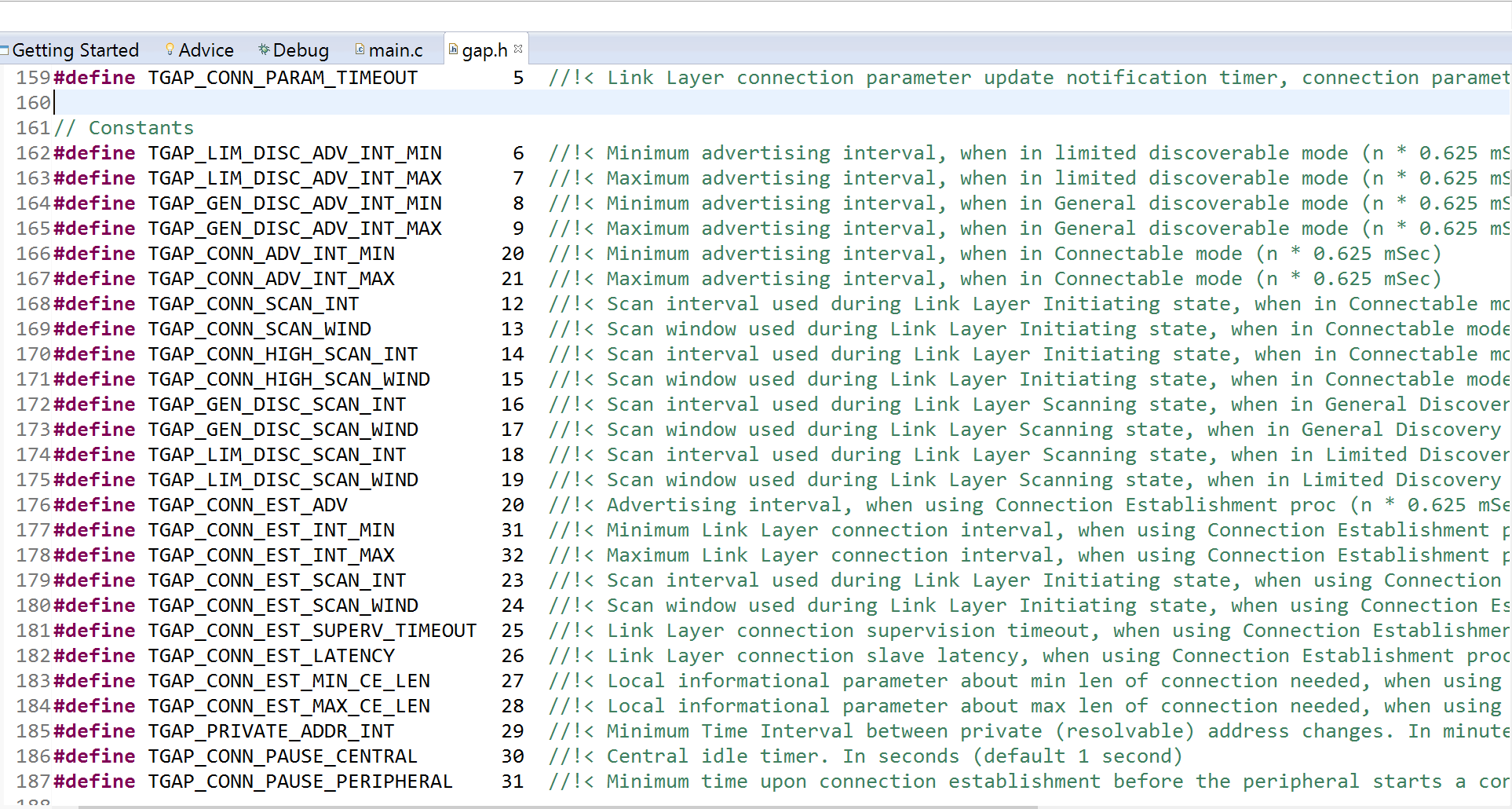

I am using CCS 6 on Win 8.1. When I debug sensortag_cc2650stk_app, I try to change advertising interval and connection interval by changing params in gap.h
And I use CC2540 to sniff, it turns out the connection interval and advertising interval remain the same, approximately 67.5ms and 104ms respectively.
How can I make this work?

  • I did. But I am not sure whether I missed something...
    I tried to use these commands to change params.
    But after I wrote these in main function, nothing changed.
    Where should I put them in ?

  • I found it in sensortag.c file. Thank you!!!
    By the way do you know how to change TGAP_LIM_ADV_TIMEOUT ? The maximum time to remain advertising. I found it is declared in gap.h but I didn't find where it is set.
  • It turns out only advertising interval is changed but connection interval remains the same... Is this related to my master device?
