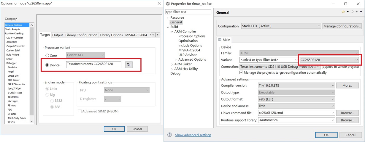

I have question:
I want to change my platform from CC2640 to CC2650 (NOT the opposite)
The multi-standard CC2650 wireless MCU supports Bluetooth low energy as well as other wireless protocols, such as ZigBee® and 6LoWPAN. The CC2640 supports Bluetooth low energy only. All code generated from the BLE-Stack v2.x SDK is binary compatible and exchangeable with both the CC2650 and CC2640 wireless MCUs.
so all the same but:
page 29 & 33:
Do not modify the CPU Variant in the project settings. All sample projects are configured with a CPU type, and changing this setting (that is, from CC2640 to CC2650) may result in build errors
also from the FAQ:
however, it is strongly recommended to not change the CPU settings in the IDE. Although the CC2650 has the HW & ROM capability to support additional wireless protocols, a given SW build can only support one wireless protocol.
What does it means "change the CPU settings in the IDE"?
