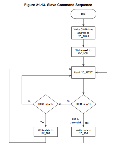

I'm trying to make a simple application in which CC2650 works as an I2C slave.
[TI UPDATE 10/12/19: The use of I2CIntRegister below in a TI-RTOS based application can corrupt the vector table. Please see this FAQ for details why this can happen: https://e2e.ti.com/support/microcontrollers/other/f/908/t/849627]
Based on this figure, my app looks like this:

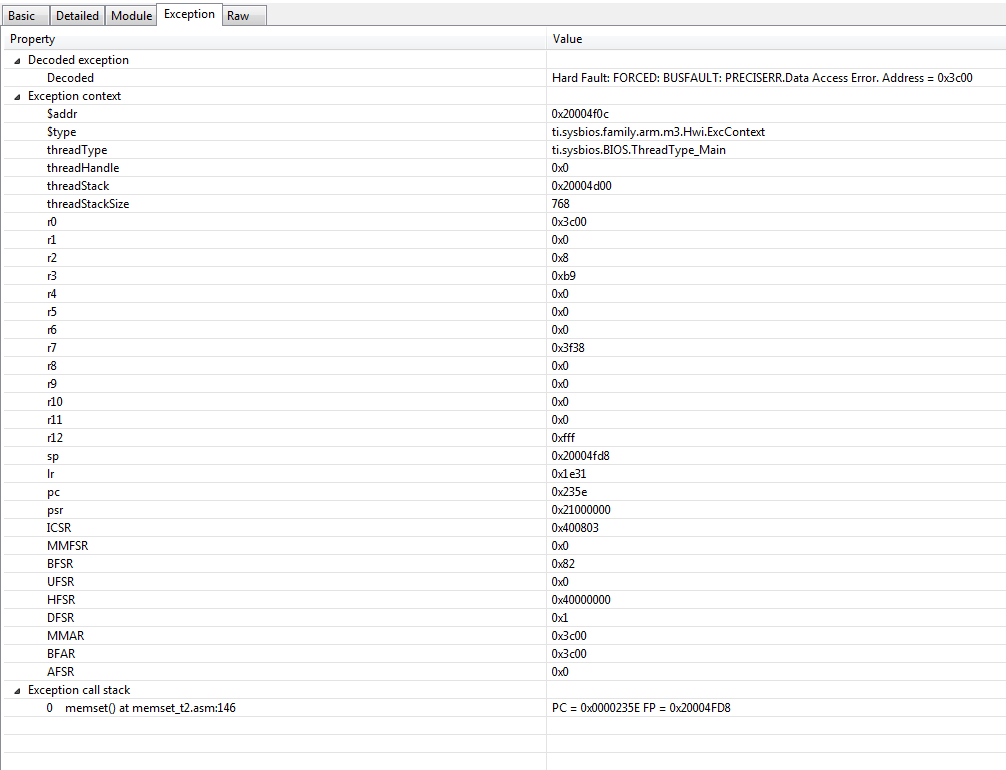

But after running the program it gets stuck in an infinite loop exception:
1001bbd8:   D0FD                beq        #0x1001bbd6
1001bbda:   4790                blx        r2

    Did you enable the power domain before calling all the register writes?
    Power_setDependency(PowerCC26XX_PERIPH_I2C0)?
    Can you add exception handle to check out the PC location ...etc? You can find the implementation on our software developer's guide chapter 9.8

    The exception handle indicates that the power domain for I2C is not on yet.
    Can you add the following code before doing any initialization? Also you need to pick 2 IOs for your SDA and SCL line.
        PRCMPowerDomainOn(PRCM_DOMAIN_PERIPH);
        Power_setDependency(PowerCC26XX_PERIPH_I2C0);
        /* Set constraints for Standby, powerdown and idle mode */
        Power_setConstraint(PowerCC26XX_SB_DISALLOW);
        Power_setConstraint(PowerCC26XX_IDLE_PD_DISALLOW);
        PRCMLoadSet();
        PRCMPeripheralRunEnable(PRCM_PERIPH_I2C0); // Enable I2C module
        PRCMLoadSet();
