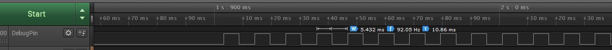

    i have done these, it works as excepted.but the Timer Max period is 2.7ms,so i want to config the TAPR =0x04
    i use the Driver: cc26xx_2_20_00_08.
    in the GPTimerCC26xx.h,i find no function to config the TAPR register, so I have been looking for a way to config the TAPR,Does the new version cc26xx_2_20_01_08 include this function to config the TAPR?
    LiNan
    Can you post your code? I have no problem using the timer to have LED toggle once every 5.4ms.
    I am using the example code I pasted above and simply change the Load value to 0x3FFFF.
    If you want to use match function then you need to change your interrupt mask from timeout to match.

    I have solved this proble.i make a miske :
    i called the function :
    GPTimeCC26XX_setMatchValue() rather than GPTimeCC26XX_setLoaderValue()
    so the Timer worked error.
    Thank u for your help and your patience!
