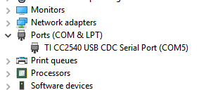

I am trying to use the CC2540 USB dongle as BLE packet sniffer. But I am unable to see it as a "Capturing Device" in the SmartRF Packet Sniffer. I read on the forums that I need to update the firmware on the dongle and I tried to update it using "Program Files (x86)\Texas Instruments\SmartRF Tools\Packet Sniffer\bin\general\firmware\sniffer_fw_cc2540_usb.hex" but I keep getting the message "Flash image overlaps with the bootloader".
I am connecting the CC Debugger to the USB dongle and I do see the green light.
The device manager shows the driver connected correctly.
Can somebody please help?

    Thank you! It was a mistake on my part.
    I am using TI Flash Programmer version 1.12.8
    The BLE sniffer Guide (processors.wiki.ti.com/.../BLE_sniffer_guide) asks the hex file to be flashed first. One thing I noticed is that in my SmartRF flash programmer, I did not see the System-on-Chip tab at all. This is because, I had selected "Program Evaluation Board" instead of "Program CCxx SoC or MSP430". Once I selected "Program CCxx SoC or MSP430", I was able to successfully program the dongle.
