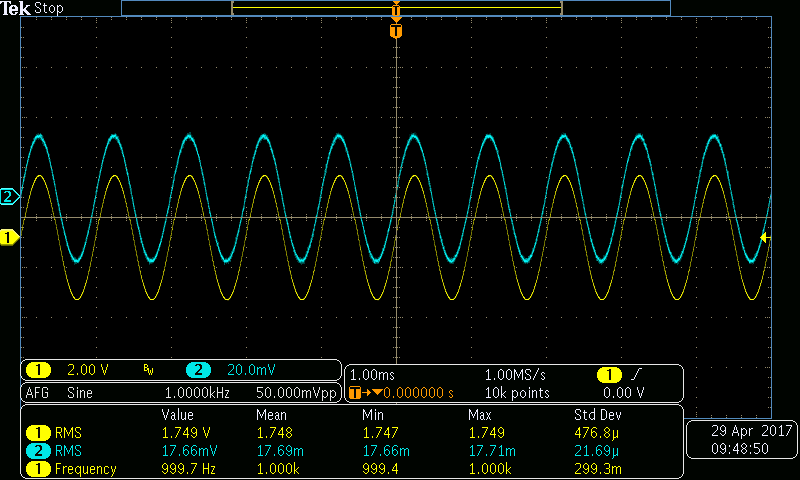

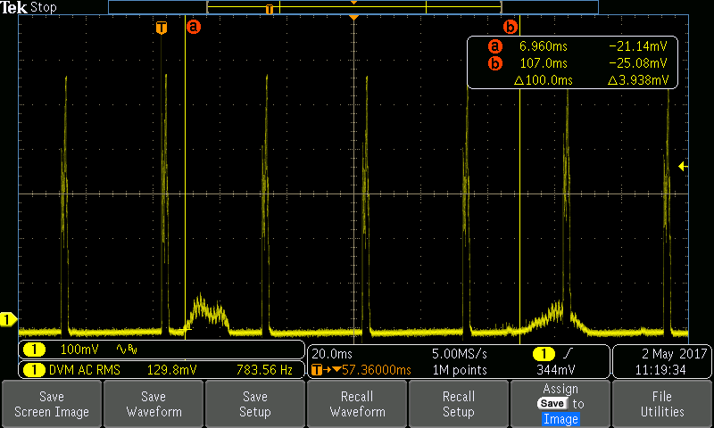

In an effort to measure current draw from my CC2640r2, I assembled the following circuit to get the voltage levels up to a point that they could be measured. I used a TI INA188 instrumentation amplifier for this purpose. Notice it uses a single gain resistor to set the gain. By using a single fixed resistor and trim pot I was able to dial in the amplifier gain to exactly 100 @ 1Khz. Also, notice that the inputs to amplifier are across  a 1 ohm resistor. This allows me to measure voltage across the shunt resistor. The CC2640r2 LaunchPad is powered from an external bench power supply connected to the 5VDC pin on the board. The circuit shown below is inserted in the circuit return path as shown. Of course there are instruments that will do all of this for you, but they're expensive. This configuration allows measurement of the parameters needed to make a pretty accurate estimate of current draw and thus battery life.

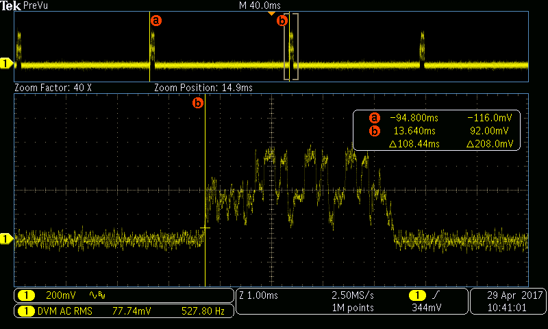

This allowed me to make some measurements of current draw as a function of time with sufficiently high resolution on the scope to capture individual BTLE connection events. Following shows the device in advertising mode. Notice that the advertising period is set to 100mS. The RMS voltage is 0.8mA (remember I'm measuring through a 100X amplifier so 77.7mV measured is actually 0.8mV)

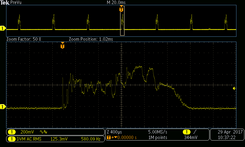

Following is a measurement of current while the CC2640r2 is connected via BTLE to a phone. Notice that since the connection events occur closer together ~30mS this condition draws more RMS current.
The other nice thing about using the scope to look at the current draw is that the individual connection events can be measured.

  • Hi JXS,
    I am not able to fully decouple the CC2650r2 from the on board debugger. So the actual current draw is around 70mA, but my scope is DC coupled so that I'm only seeing the current draw from non-DC events like the radio. I think the DC/DC recharge pulses may be too small to see and buried in the DC signal. Please let me know if I'm wrong. I tried to disconnect all of the jumpers assuming that the CC2650 would be the only thing operating as was suggested in an alternate post, but unfortunately with all of the jumpers disconnected, the CC2650 doesn't function. I'd be happy to make some more measurements - suggestions?
    Patrick
  • OK, I may have found the DC-DC recharging that you suggested may be here. Unfortunately because I can't completely isolate the CC2640r2 from the on-board (CC2640r2 Launch Pad) debugger, I can't be sure that the signal that I measured is from any identifiable source - it could be the DC-DC converter but I'm not sure. Furthermore, these sequential scans are from paired vs unpaired conditions. I find it very interesting that 100mS current draw is larger while not paired with the phone. This makes me think that the cause is something unrelated to the CC2640r2.
    Thoughts?
    Notice the relative slow (~1kHz) broad current draw. This may be due to the DC-DC recharging event. A note, the scope is set to acquire in average mode while taking 128 averages, thus the fine detail, but in actuality the small broad current events go to nearly zero when paired as the device is in this case. This is a very nice technique to watch the current state change slowly while the device is paired and then unpaired.
    Here with the device unpaired, the slow current events are more prominent.

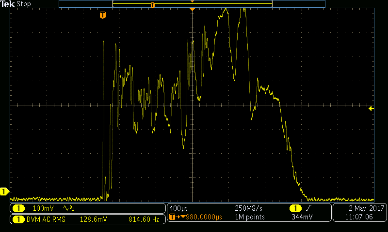

    Simply included to show a single BLE pulse as measured on the scope
    Lastly, showing the performance of the amplifier and verifying its gain of 100 at 1kHz.

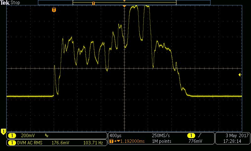

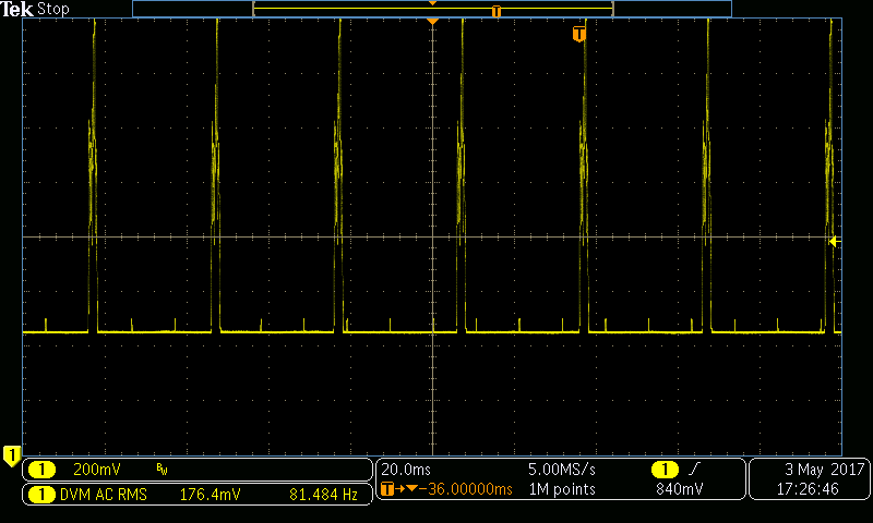

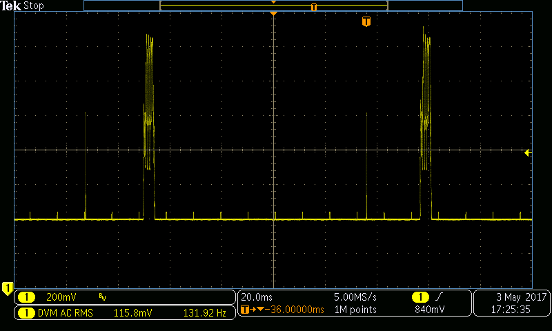

  • Hello Fredrik,
    Thank you for your kind words of encouragement. I took your advice and configured the CC2640r2 as you suggested - only the VSENSE jumper, GND to my circuit, and 3.0VDC from my lab power supply to the board connected. The results were similar to those shown previously but without the DC offset - likely due in large part to the LED. For completeness I've attached my results here.
    With the device unpaired (disconnected) the CC2640 draws ~ 1.1mA RMS. Notice the small spikes. I'll show those later. This may be the DC-DC converter.
    With the device connected, the CC2640r2 draws ~1.8mA RMS.
    Single BLE pulse ~12mA peak

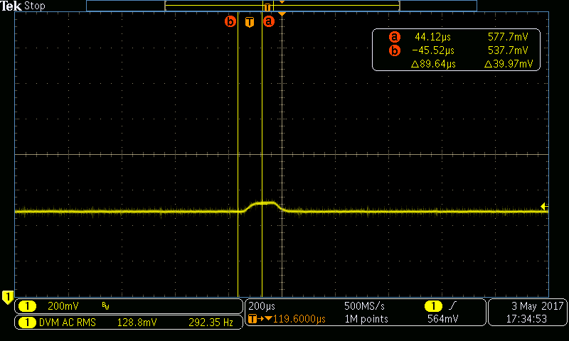

    Very small pulses shown previously <200microseconds and 0.4mA Pk. This may be the DC-DC Converter recharge.
    This is a less frequent but larger peak current draw ~0.7mA over 40ish microseconds.
