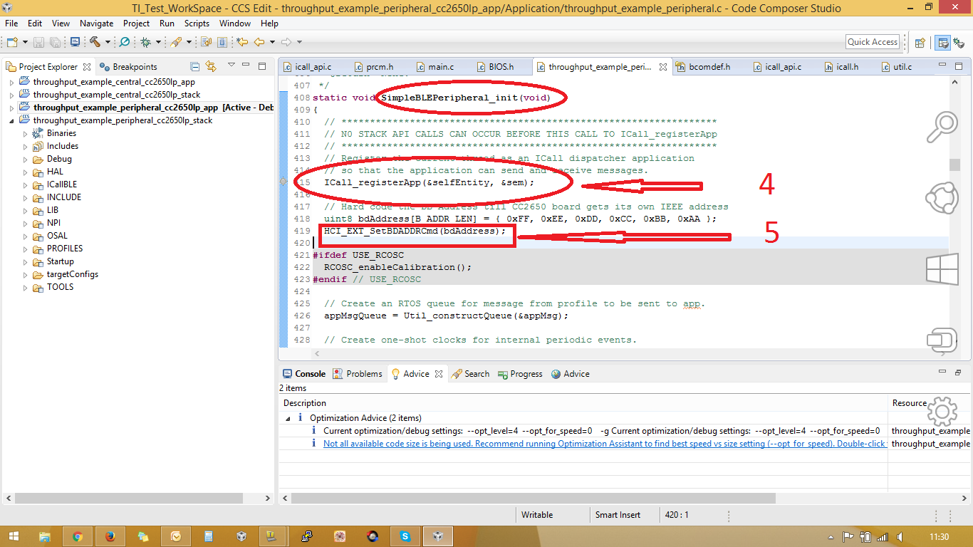

I am getting struck "ICALL_ERRNO_UNKNOWN_THREAD"
Explained way:
Inside this function = static bStatus_t sendWaitMatchCS(ICall_EntityID src, void *msg, ICall_MsgMatchFn matchCSFn)
"waitMatchCS(matchCSFn, (void **)&pCmdStatus);" is not giving any return response.
inside "WaitMatchCS" function its struck in return "ICALL_ERRNO_UNKNOWN_THREAD;"
Could you help me - Why my program got struck here please?

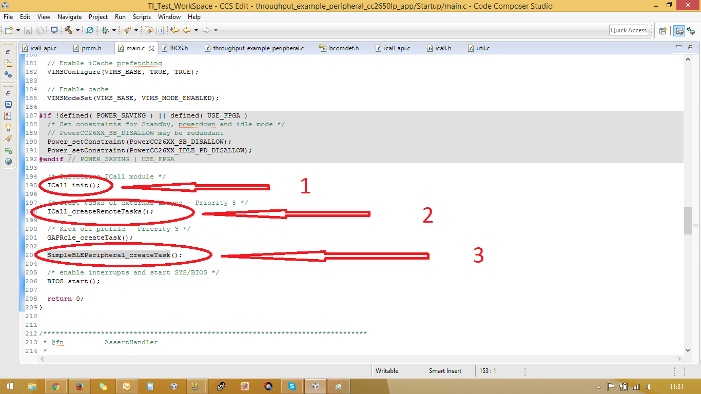

  • Hi Mano,
    This usually happens when you haven't registered a task with ICall or if you haven't initialized an ICall entity (eg GATT Client)
    Take a look at simple_peripehral's initialization function for how to register with ICall. software-dl.ti.com/.../the-application.html
    Rebel
  • Hi Rebel,
    Thanks for your valuable Reply,
    Here i am calling that function also.
    Here i attached my screen shot.
    Kindly please look at it. if i am missing some thing Please let me know..
    If i want to more configuration also - Please let me know.
    The Numbers are showing that - Flow of the Program.
    And the struck up happening inside the 5th Function.
    Could Please help me now?
