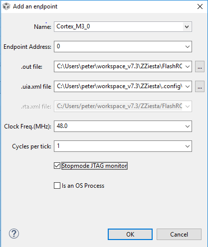

I am developing a wireless project using the CC2640R2 LaunchPad. I started with the simple_peripheral exampleand have made changes to it to create my own Gatt profile. All is working fine. Now, I want to add UIA to the project so I can use RTOS Analyzer but I get the "Could not detect UIA configuration" error dialog. I have read multiple posts about this error and tried many of the solutions including using LoggingSetup, with no success. My cfg file, which I cloned from cc2640_r2_csdk.cfg is attached.
I am using:
CCS 7.3.0.00019
SDK 1.50.0.58
XDC 3.50.3.33
Any help in solving this is greatly appreciated.
Peter
ZZiesta.cfg

  • I finally resolved this on my own, by creating a custom UIA config file.
    When the error dialog displays, check the Custom UIA Configuration file check box, and then click on Create UAI Config File.  This presents the UIA Config dialog.  Click on add endpoint and fill out the Add and endpoint dialog.
    Select a name, in my case Cortex_M3_0,
    Leave Endpoint Address 0
    If it does not find your out file, browse for it
    I had to browse for the uia.xml file whcih is what actually solved the problem
    Set the clock freq, in my case 48.0
    And I checked Stopmode JTAG monitor
    I hope this helps anyone else who has been having this problem
