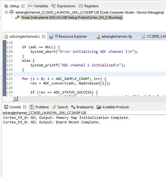

I have used TI Resource Explorer to load adcsinglechannel into CCS7.0.0.00042.
I have a CC2650 launchpad that I can debug and break the code, but I can not see any System_printf output in the console.

    Am I looking for the System_printf output in the correct place, the console window?
  • Yes, it should output on console window.

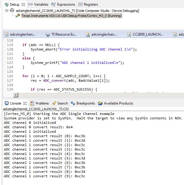

  • I test ADC example on my LAUNCHXL-CC2650 and see it works by default.
  • Thanks for taking the time to do that.
    Below is what I get on a clean and running install.

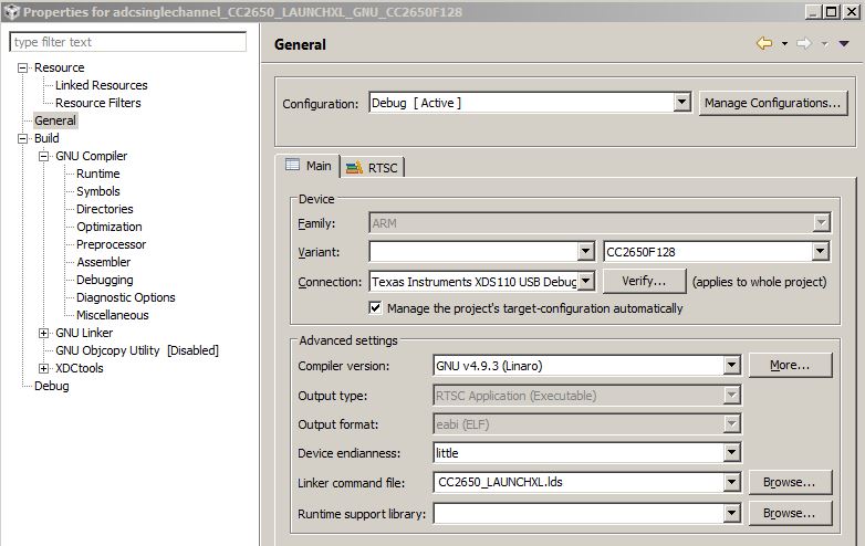

    At least we know it is not in the project code or properties?, looks to me like something not right in my CCS7 setup, but what?
    Although I see our project is named differently, I got mine from the Classic explorer.
  • I use CCS 7.3. Maybe you can try this version.
  • Different file name was it!!!!
    If you download the example using TIREX (TI Resource Explorer) 'Classic', then you get no output in console and a different filename.
    I have not been using TIREX from the cloud (or whatever) because it was not loading, I just now upgraded TIREX without upgrading my CS7 version (which did not complete properly) but I was able to get the same filename (as working above) imported into my IDE and it works, see below.
