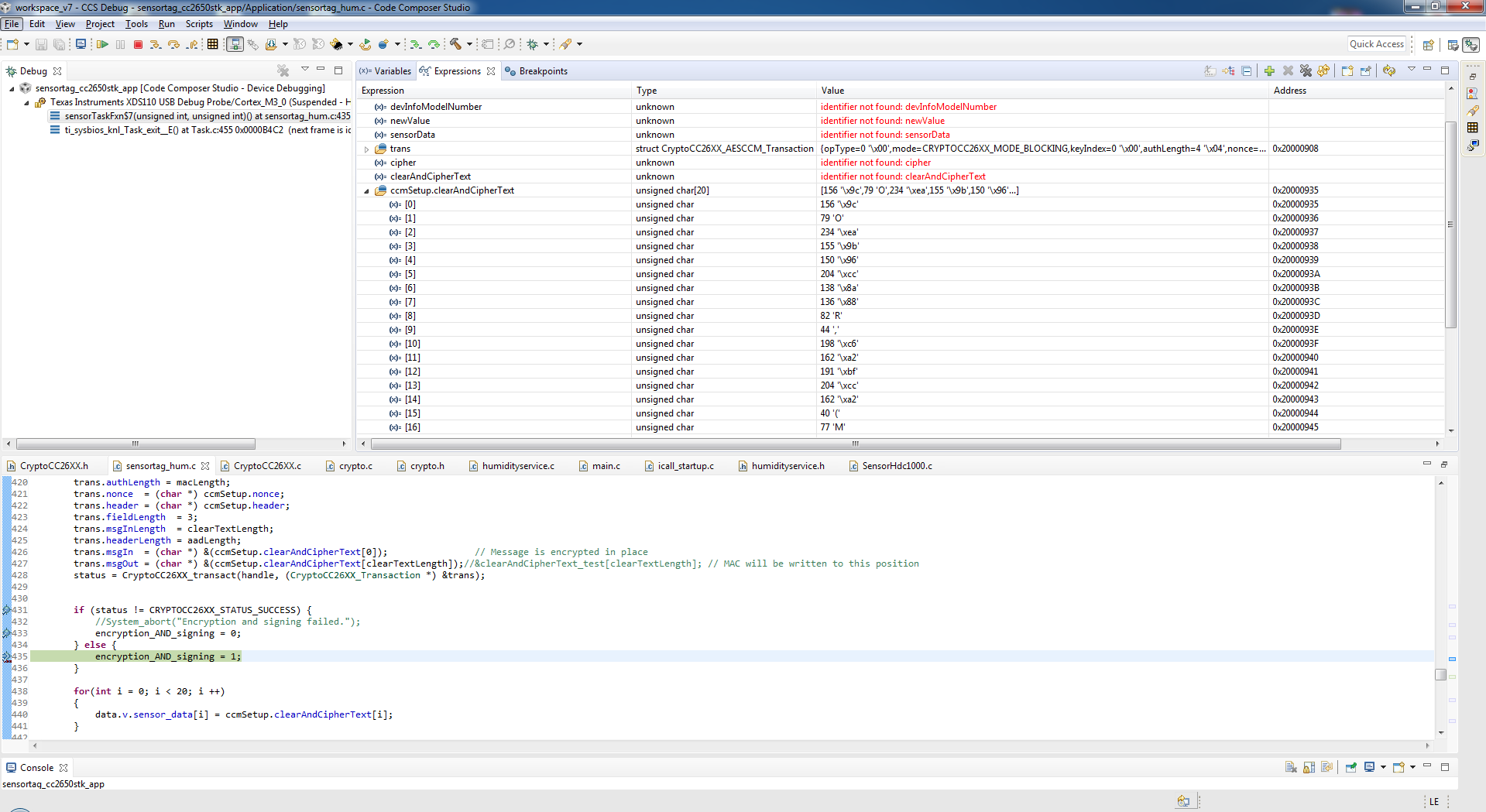

  • Hi Eagle5,
    trans.msgOut might be optimized out depending on your compiler settings. The encrypted message gets stored in the clearAndCipherText array after the encryption process. In the sample usage code from the CryptoCC26XX usage guide you referenced, what is the value of clearAndCipherText after the call to CryptoCC26XX_transact in the "Encrypt and authenticate the message" section?
  •  Hi RachelP,
    Unfortunately I can't even see the variable clearAndCipherText while in a debug session.. Also adding ccmSetup.clearAndCipherText to the expressions didn't helped.
    I made the breakpoint right before the decryption would start. So I expect that the ccmSetup.clearAndCipherText array would hold the ciphertext.
  • Hi RachelP,
    I managed to see the variables while debugging now (just declared them as global variables..).
    I'was also able to transmit the encrypted content to the IOS - Sensortag- app where I can see the encrypted cipher of
     ccmSetup.clearAndCipherText = { 't','h','i','s','i','s','a','p','l','a','i','n','t','e','x','t','0','0','0','0' },
    but the problem now is that it encrypts the content twice. Which means on the "first" time it decrypts wihout a problem and gives me the following chiper+mac message:
    	[0]	unsigned char	156 '\x9c'	0x20000935
    	[1]	unsigned char	79 'O'	0x20000936
    	[2]	unsigned char	234 '\xea'	0x20000937
    	[3]	unsigned char	155 '\x9b'	0x20000938
    	[4]	unsigned char	150 '\x96'	0x20000939
    	[5]	unsigned char	204 '\xcc'	0x2000093A
    	[6]	unsigned char	138 '\x8a'	0x2000093B
    	[7]	unsigned char	136 '\x88'	0x2000093C
    	[8]	unsigned char	82 'R'	0x2000093D
    	[9]	unsigned char	44 ','	0x2000093E
    	[10]	unsigned char	198 '\xc6'	0x2000093F
    	[11]	unsigned char	162 '\xa2'	0x20000940
    	[12]	unsigned char	191 '\xbf'	0x20000941
    	[13]	unsigned char	204 '\xcc'	0x20000942
    	[14]	unsigned char	162 '\xa2'	0x20000943
    	[15]	unsigned char	40 '('	0x20000944
    	[16]	unsigned char	77 'M'	0x20000945
    	[17]	unsigned char	92 '\'	0x20000946
    	[18]	unsigned char	144 '\x90'	0x20000947
    	[19]	unsigned char	124 '|'	0x20000948
    In the IOS-App I see the following string:
    9c4fea9b 96cc8a88 522cc6a2 bfcca228 4d5c907c
    which is the expected chiper+mac (see the picture below).
    But then it tries again to encrypt, but fails which gives me than this message (this is what I can see with my IOS-app, as soon as the config of the humidity is set to 0x01, the sensor data will be displayed/transmitted):
    74686973 69736170 6c61696e 74657874 a92b8239
    Here is the picture, while debugging:
    As you can see the encryption and signing fails (as you can see the clearAndCipherText is still "the old one" --> it does not match what I see every second time with the IOS-App).
    Do you have a clue, what is wrong?
    Thank you in advance

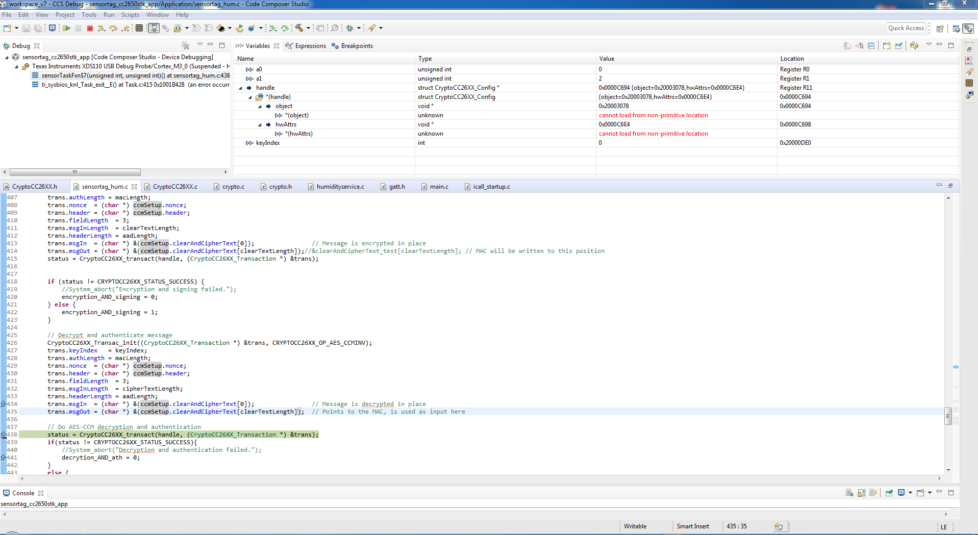

  • I'v tried also to decrypt the ciphertext, which I have obtained while debugging --> I'm using a python2 script.
    I don't know if its right, but it seems to me that the decryption is somehow wrong?
    because I always get:
    [0]	unsigned char	116 't'	0x20000935
    [1]	unsigned char	104 'h'	0x20000936
    [2]	unsigned char	105 'i'	0x20000937
    [3]	unsigned char	115 's'	0x20000938
    [4]	unsigned char	105 'i'	0x20000939
    [5]	unsigned char	115 's'	0x2000093A
    [6]	unsigned char	97 'a'	0x2000093B
    [7]	unsigned char	112 'p'	0x2000093C
    [8]	unsigned char	108 'l'	0x2000093D
    [9]	unsigned char	97 'a'	0x2000093E
    [10]	unsigned char	105 'i'	0x2000093F
    [11]	unsigned char	110 'n'	0x20000940
    [12]	unsigned char	116 't'	0x20000941
    [13]	unsigned char	101 'e'	0x20000942
    [14]	unsigned char	120 'x'	0x20000943
    [15]	unsigned char	116 't'	0x20000944
    Instead of the original plaintext:

            // Encrypt and authenticate the message
            CryptoCC26XX_Transac_init((CryptoCC26XX_Transaction *) &trans, CRYPTOCC26XX_OP_AES_CCM);
            trans.keyIndex   = keyIndex;
            trans.authLength = macLength;
            trans.nonce  = (char *) ccmSetup.nonce;
            trans.header = (char *) ccmSetup.header;
            trans.fieldLength  = 3;
            trans.msgInLength  = clearTextLength;
            trans.headerLength = aadLength;
            trans.msgIn  = (char *) &(ccmSetup.clearAndCipherText[0]);                // Message is encrypted in place
            trans.msgOut = (char *) &(ccmSetup.clearAndCipherText[clearTextLength]);//&clearAndCipherText_test[clearTextLength]; // MAC will be written to this position
            status = CryptoCC26XX_transact(handle, (CryptoCC26XX_Transaction *) &trans);
            if (status != CRYPTOCC26XX_STATUS_SUCCESS) {
                //System_abort("Encryption and signing failed.");
                encryption_AND_signing = 0;
            } else {
                encryption_AND_signing = 1;
            for(int i = 0; i < 20; i ++)
                data.v.sensor_data[i] = ccmSetup.clearAndCipherText[i];
            // Decrypt and authenticate message
            CryptoCC26XX_Transac_init((CryptoCC26XX_Transaction *) &trans, CRYPTOCC26XX_OP_AES_CCMINV);
            trans.msgInLength  = cipherTextLength;
            trans.msgIn  = (char *) &(ccmSetup.clearAndCipherText[0]);                // Message is decrypted in place
            trans.msgOut = (char *) &(ccmSetup.clearAndCipherText[clearTextLength]);  // Points to the MAC, is used as input here
            // Do AES-CCM decryption and authentication
            if(status != CRYPTOCC26XX_STATUS_SUCCESS){
                //System_abort("Decryption and authentication failed.");
                decrytion_AND_ath = 0;
            else {
                decrytion_AND_ath = 1;

  • Until now encryption and decryption was always right (on the sensor-side) it was a mistake in my python script.
    But the problem with a "double encryption" inside the humidity-task remains.
    I moved the Initialization of the crypto driver to the init function of the humidity task:

          ccmSetup.clearAndCipherText[0]=LowerByteTemp;
          ccmSetup.clearAndCipherText[1]=UpperByteTemp;
          LowerByteHum = (uint8_t)test_rawHum;
          UpperByteHum = (uint8_t)(test_rawHum >> 8);
          ccmSetup.clearAndCipherText[2]=LowerByteHum;
          ccmSetup.clearAndCipherText[3]=UpperByteHum;
          //TODO: Encrypt sensor data here
            // Open the crypto hardware with non-exclusive access and default parameters.
            handle = CryptoCC26XX_open(Board_CRYPTO, false, NULL);
            if (handle == NULL) {
                //System_abort("CryptoCC26XX did not open");
                cryptoOpen = 0;
            }else{
                cryptoOpen = 1;
            // Allocate a key storage location in the hardware
            keyIndex = CryptoCC26XX_allocateKey(handle, ccmSetup.keyLocation, (const uint32_t *) ccmSetup.key);
            if (keyIndex == CRYPTOCC26XX_STATUS_ERROR) {
                //System_abort("Key Location was not allocated.");
                keyLocation = 0;
            } else {
                keyLocation = 1;
            } else {
            // Release the key location
            status = CryptoCC26XX_releaseKey(handle, &keyIndex);
                //System_abort("Key release was not successful.");
                keyRealease = 0;
            } else {
                keyRealease = 1;
            // 3. Send data
            Humidity_setParameter(SENSOR_DATA, SENSOR_DATA_LEN, data.a);
            // 4. Wait until next cycle

    Is it a wrong initialization of the crypto methods? Or do I just wrongly use the crypto methods?
    Thanks in advance
