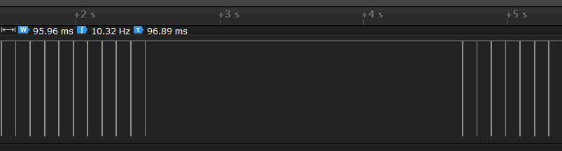

  • Maybe a picture can clarify what i want:
    The yellow marked interrupt from Timer B occurs every 350 ms (LoadValue 0xFFFFFF with timer frequency 48 MHz), although the callback from Timer A is called often in between which should reset Timer B to zero again, so that it can never trigger an interrupt.

  • Hard to say without having the complete picture, could you provide a project I can look out and test out to see how everything is setup?

  • Now it stopped sending in between, but when no rising edges for Timer A are coming (no interrupt from Timer A)  and Timer B should be triggering an interrupt it does not.
