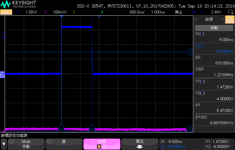

    I wrote some testing pseudo code to test GPIO speed. AUXIO_O_DIN0 is my input pin = DIO27; AUXIO_O_HIGH is my output pin = DIO30.
    In "Execution Code", I wrote:
    U16 signal;
    gpioSetOutput(AUXIO_O_HIGH);
    gpioGetInputValue(AUXIO_I_DIN0; signal);
    gpioClearOutput(AUXIO_O_HIGH);
    // Schedule the next execution
    fwScheduleTask(1);
    And I got waveform like this.
    The delta x should be the (sampling period) + (output period) = 819ns.

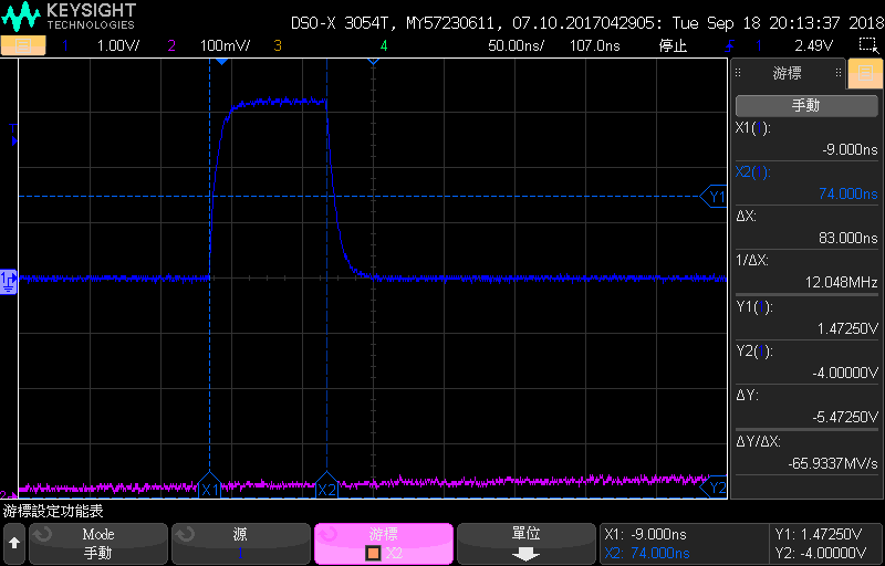

    To clarify the amount of each parts, I wrote another pseudo code:
    U16 signal;
    fwScheduleTask(1);
    And I got the waveform like this,
    delta x should be only output period = 83ns. (12MHz).
    From output period, I can calculate the input period = 736ns. (1.4MHz).
    So I think this is the highest speed of GPIO on sensor controller. (output 12MHz, input 1.4MHz)
    Could you please help me to confirm from hardware spec? I am not sure if there is something ignored.
