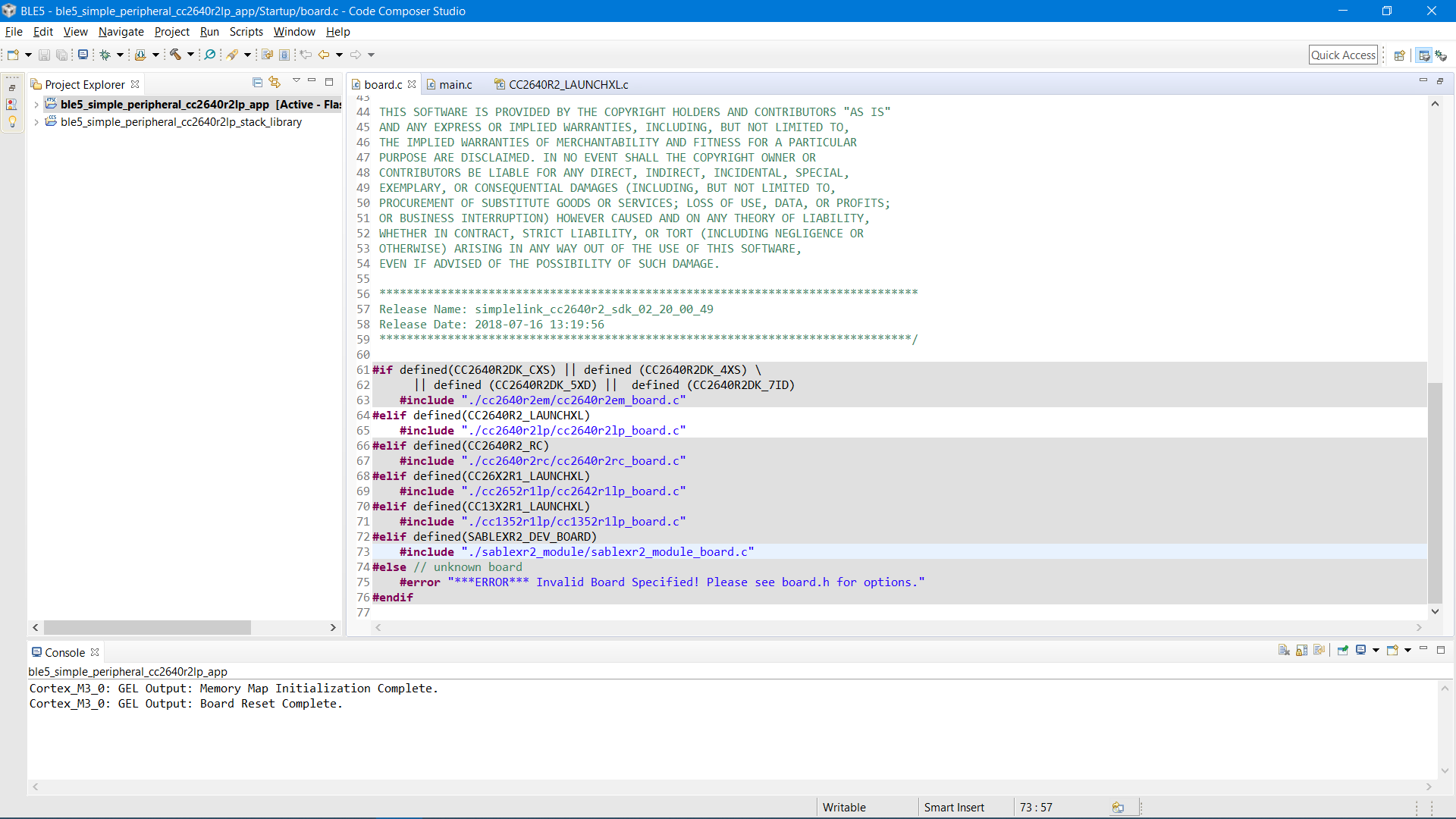

I have ported my SaBLE-x-R2 development board and built it and debugged it. When I start the debugging sequence and the stop it, i find out that the program is using the CC2640R2_LAUNCHXL.c  board file, and not my SABLEXR2_DEV_BOARD.c . What could be the problem? The path in the main board.c file is well defined:
#if defined(CC2640R2DK_CXS) || defined (CC2640R2DK_4XS) \
|| defined (CC2640R2DK_5XD) || defined (CC2640R2DK_7ID)
#include "./cc2640r2em/cc2640r2em_board.c"
#elif defined(CC2640R2_LAUNCHXL)
#include "./cc2640r2lp/cc2640r2lp_board.c"
#elif defined(CC2640R2_RC)
#include "./cc2640r2rc/cc2640r2rc_board.c"
#elif defined(CC26X2R1_LAUNCHXL)
#include "./cc2652r1lp/cc2642r1lp_board.c"
#elif defined(CC13X2R1_LAUNCHXL)
#include "./cc1352r1lp/cc1352r1lp_board.c"
#elif defined(SABLEXR2_DEV_BOARD)
#include "./sablexr2_module/sablexr2_module_board.c"
#else // unknown board
#error "***ERROR*** Invalid Board Specified! Please see board.h for options."
#endif

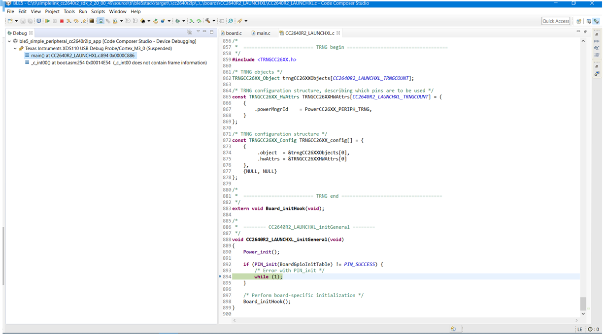

    i can do the debug, but i think it is not debugging at all. The debug console says:
    Cortex_M3_0: GEL Output: Memory Map Initialization Complete.
    Cortex_M3_0: GEL Output: Board Reset Complete.
    But when i play the Debug, and suspend it, i have the output as seen on the picture. Why does he open the CC2640R2_LAUNCHXL.c file although it is not the name of my target board ( SABLEXR2_DEV_BOARD is the name of my target board). I suspect that the debugger stops at the while(1) line becouse it is not able to initialise the GPIO pins. Then the problem is how can I tell him no to look at the CC2640R2_LAUNCHXL?

  • This is the board.c file code:
  • The newest SDK have the predefined in a .opt file.
    Please take a look at this section:
    dev.ti.com/.../creating-a-custom-bluetooth-low-energy-application.html
  • Hi Alen,
        As you can see at board.c the SABLEXR2_DEV_BOARD is not highlighted meaning you did not set the SABLEXR2_DEV_BOARD at CCS Project Properties->Build->ARM Compiler->Predefined Symbol.
        Alternatively you can do this below as I have mentioned earlier.
    -kel

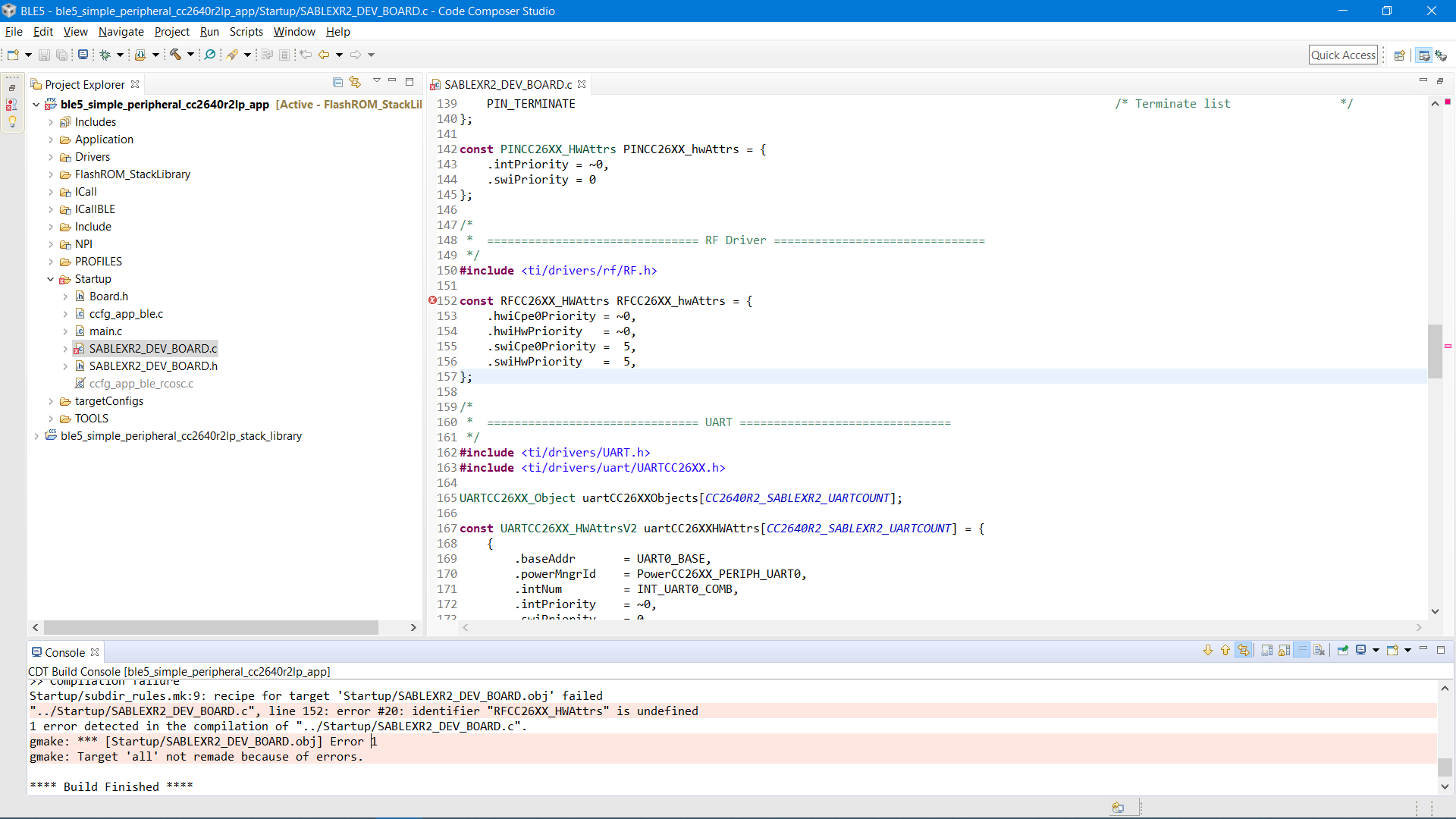

  • I have done as you said, but now a have a error:
  • Hi Alen,
    Your SABLEXR2_DEV_BOARD board files maybe not compatible with SDK 2.20. So use the CC2640R2F_LAUNCHXL board files and make modifications according to the SABLEXR2_DEV_BOARD pin outs.
    -kel
  • Do you claim this RFCCC26xx_hwAttrs by yourself?
  • No, the SABLEXR2_DEV_BOARD.c is LSR made and i haven't made any changes to it. I should mention that their porting guide was written for CC2640R2F SDK v1.35.00.33 and I'm using SDK 2_20_00_49. I have changed the "RF Driver" part according to CC2640R2F_LAUNCHXL.c, but encountered two more errors:

  • I've done it. LSR is going to make some changes on the porting guide instructions for the new SDK versions, and they gave me the new files which are about to be uploaded on the web. With these files, one fresh install of SDK, and (I think this is the core issues) by putting the SABLEXR2_DEV_BOARD Pre-defined NAME in the Predefined Symbols section in the first place i was able to normally build and debug the project. Thank you all for helping.
