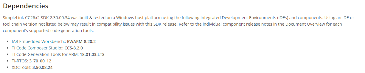

  • For SDK 2.30, you need to use 18.01.03.LTS.
    Can you run the software with correct compiler version again?
  • My colleague attempted to do this, and found an 18.9, but it wouldn't let him do 18.01.  It also resulted in a number of errors.  I will see if I can get him to share some details on this, but in the meantime, what is the best way to go about this?  I saw nothing in the documentation here that mentioned this as a requirement.  Where can we find the requirements listed, and a guide that shows the proper way to update?
  • The requirement is listed in release note. Release note comes with the SDK installation:
    ti/simplelink_cc26x2_sdk_2_30_00_34/release_notes_simplelink_cc26x2_sdk_2_30_00_34.html
    You can also use CCS 8.2 to see if it gives you less trouble.
    Are you able to produce the issue with correct compiler settings?
