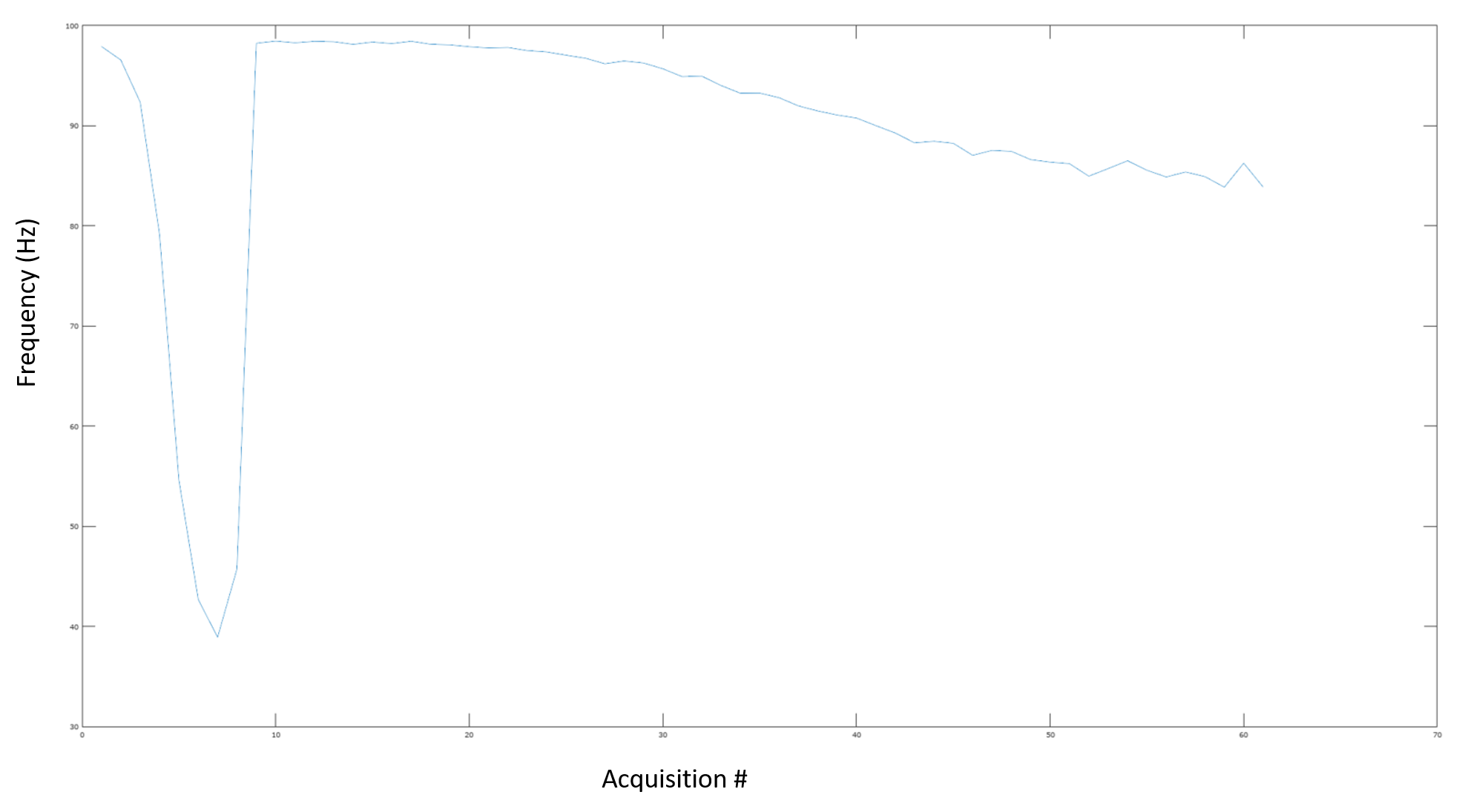

I started doing some tests, and I found a strange behavior of the sampling frequency, it normally acquires at 100Hz but sometimes the frequency goes down to 30Hz.
After this I modified my App in order to start/stop an acquisition every minute for one hour, in order to asses the frequency behavior of each acquisition.
Attached is a figure with the mean acquisition frequency, over the several acquisitions. In which it can be seen how the frequency falls to 30Hz and at some point rises again to 100Hz.

I have considered elements as the battery charge, the timestamps (they were originally added from the app and now the come from the SensorTag itself), and the app itself. But I don't seem to find an explanation to this behavior nor a solution. I find it very strange, but now I'm guessing is a problem of the device itself or the data transmission.
Any ideas on why this is happening? Or any suggestions on how to fix this?

    It is not really clear what you are showing in the last plots. You should anyway debug the application code on the CC2650 to try to figure this out.

    How do you suggest me to debug the application code, considering that the frequency behavior is completely random and I cannot predict when will it happen?
    Also, what is not clear for you from the plots?
    Maybe I can clarify them for you so we can try to be on the same page here.
