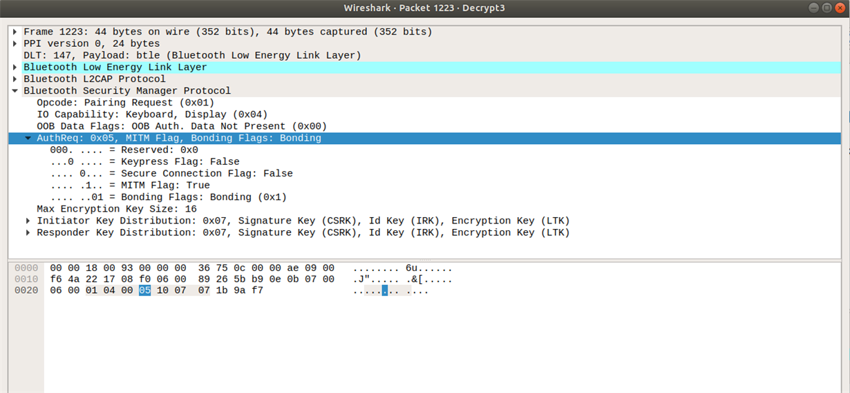

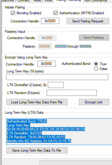

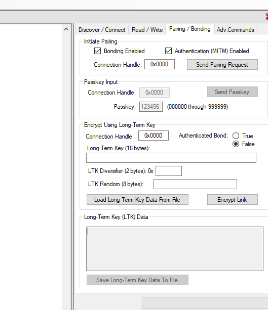

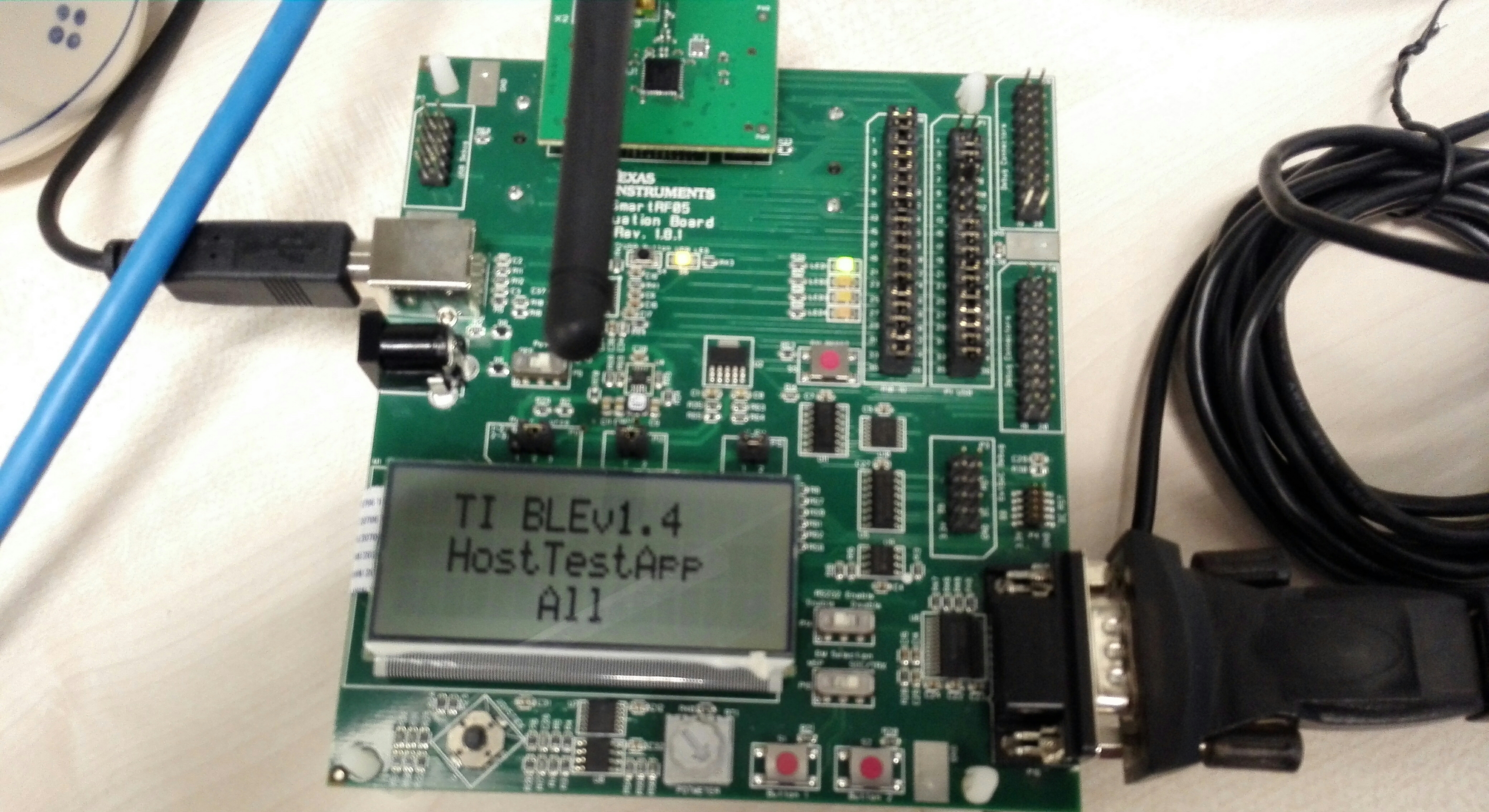

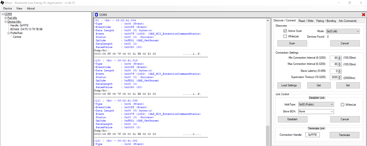

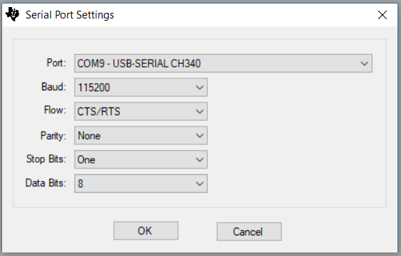

Hi all,

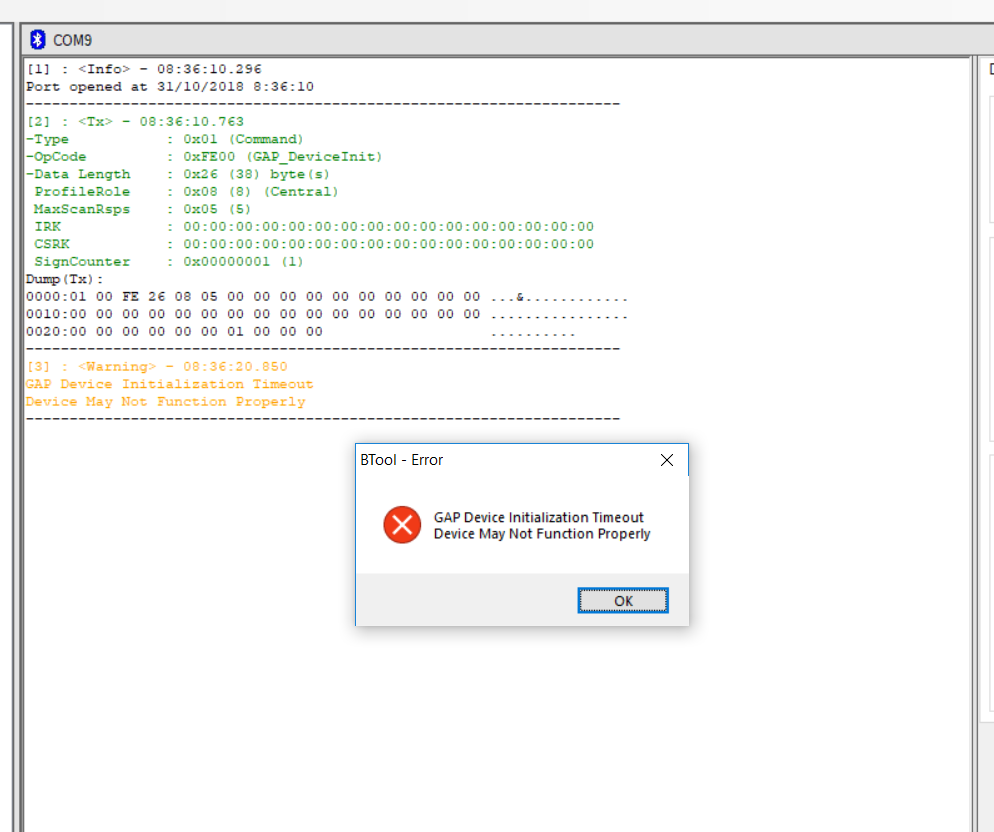

I am using BTool in order to analyse the connection between two CC2540DK. I set one as the HostTestAppAll and the other as a Peripheral. Then, central device scan the peripheral using BTool. Once the connection is established, i tried to use passkey funtionality to pairing process. However the error  the error GAP_BondComplete: Failed Invalid Event ID is recived. Following a forum recommendation i tried to connect also the peripheral device to Btool in other to set the pass key in both. However i can't to connect it to btool due to figure errors.
Is possible to connect CC2540DK with peripheral firmware to Btool?
I appreaciate the response.
