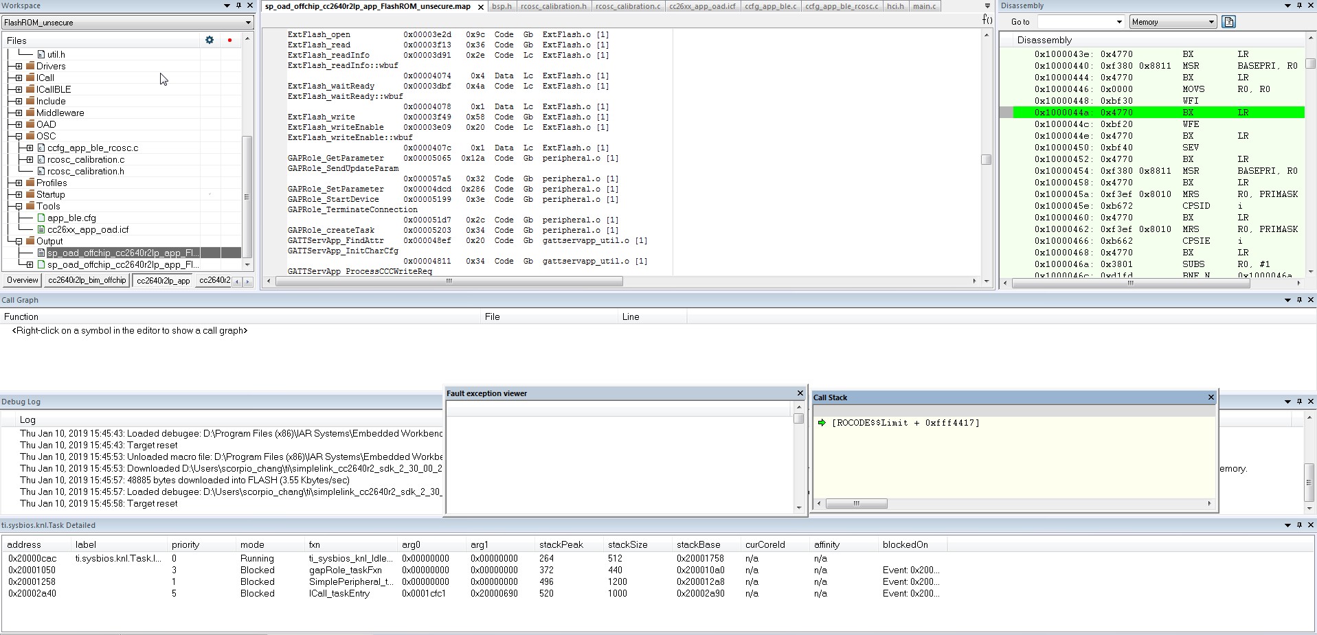

    rebuilding all project and flashing image to test PCB, hope it works fine, but we suffer another problem,  app stop at [ROCODE$$Limit + 0xfff4419]
    we search the forum and find some post talk about this issue as below:
    https://e2e.ti.com/support/wireless-connectivity/bluetooth/f/538/t/743865?CC2640R2F-ROCODE-Limit-displayed-on-the-call-stack
    https://e2e.ti.com/support/tools/ccs/f/81/t/758546
    it looks like stack or heap issue.
    But, we observe stack usage that does not overflow.  do we need to check any configuration?
    thank you.
    The thread you have linked from Tim C explains why the call stack is non-sensical. It is because 0x1000044A corresponds with the TI-RTOS in ROM kernel and the symbols are not loaded for the RTOS ROM.
    By the way, 0x1000044A corresponds with the WFI instruction if I am not mistaken ( you can check by following the guide to load symbols here: ) so the device has not crashed, but instead seems to be in a pend loop.
    Can you enable heapmgr metrics and be sure that the stack is out out of memory (i.e. heapmgrMemfail == 0). More information on heap debugging is also in the debug guide I have linked above:
    dev.ti.com/.../
