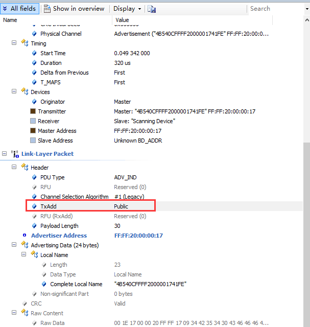

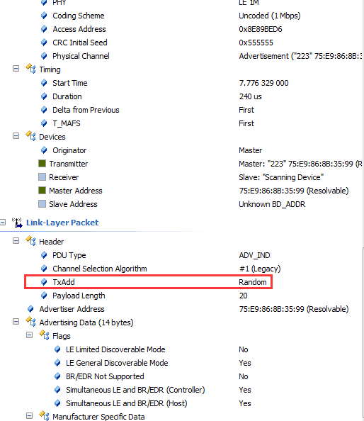

  • Hello Eirik,
    the different between the 2640R2 and the phone advertising  is the addresstype, the 2640R2 is the "Public addresstype"and the phone is "random addresstype",show as below:

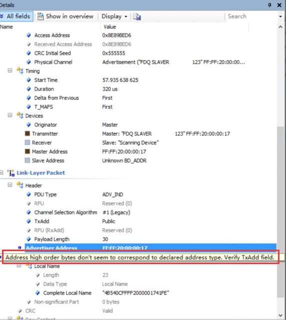

  • What happens if you change the 2640R2 device address to random?
    There could be difference in link quality which can cause advertisements from the mobile phone to be missed. If you run a single scan duration shorter than the advertising interval of the mobile phone you might very well never catch the packet. In theory this could also occur with the 2640R2 as broadcaster.
  • Hello Eirik,
    I tried to set 2640R2 device address to random, but it doesn't work, I also tried to set the address of 2640R2 to be the same as the mobile phone., It also offers the following tips:
