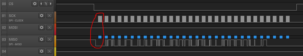

Logic analyzer:(MOSI is not connected to logic analyzer)
Result:
SPI Master Sent:master_tx[30]={0,1,2,3,...,28,29}
                   Received:master_rx[30]="\0ello from slaver, msg#: 1"     //why first byte is 0x00,others bytes are correct
SPI Slave Sent: tx[30] = "Hello from slaver, msg#: 1"
                 Received: rx[30] = {0,1,2,3,...,28,29}        //Correct
Why SPI Master receive first byte is 0x00,where am I wrong

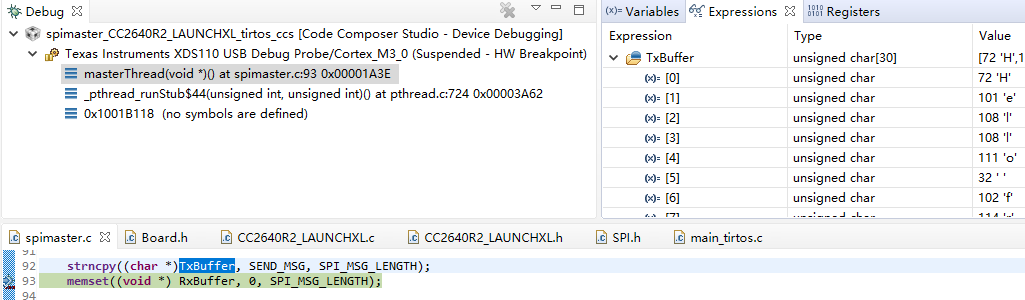

    Have you put a breakpoint after memset((void *) RxBuffer, 0, SPI_MSG_LENGTH) and verified that TxBuffer is copied correctly?

  • 1. Here is the screenshot that I put a breakpoint after memset((void *) RxBuffer, 0, SPI_MSG_LENGTH) and verified that TxBuffer is copied correctly
    2. If I repeat the sequence, my first byte is always 0x00,and other bytes are always correct

    If you do not physically connect your SPI master MISO line, do you still see that first byte is output 0 with logic analyzer? I'm thinking that your SPI Master might force the MISO line low for some reason in the beginning.
