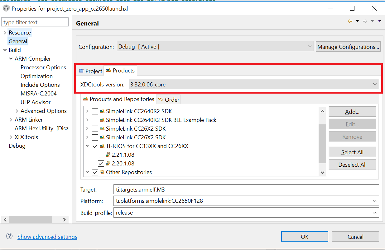

  • The tool chain seems to be correct.
    To check XDCTools version used in the project. Please navigate to the following place:
    Without reimporting, you are gonna have the same issue as building error which will then not give you a .out file for debugging.
    You need to either delete the old projects by right click or creating another workspace before you re-import it again.
    If you still have the same problem, please attach build msg following the instruction below:
    Q: I’m still getting build errors of some kind.
    A: Please use the E2E "Insert Code, Attach Files and more" option and attach your IAR or CCS build log (paperclip icon). Note that for IAR, you must enable the build log: Tools -> Options -> Messages -> Log build messages to file. Please compress the file as needed. Attaching the build file, and not just the snippet showing the error, is critical to determine the build environment and other factors needed to diagnose your build error.
