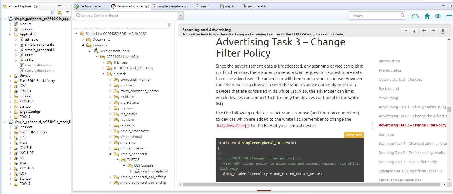

I'm new user of this TI product, and performing many trials before developping a new project.
At this step, I'm trying to inhibit connexion from any device except the one which is declared in the whitelist.
I follow the explanation supplied in the lab for advertising filtering, but can't have a correct result.

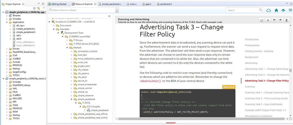

Here is a screenshot of the context I'm talking about :
- Example program : "simple_peripheral" from "blestack" of "cc2640r2 LaunchPad" in "SimpleLink CC2640R2 SDK - v:2.40..."
- Lab from "Simple Link Academy v:2.40.03..." chapter "Bluetooth 4.2 - Scanning and Advertising", and "Task 3".
I made no other modification and tested with a smartphone running "BLE Scanner" on Androïd.
The problem is that I can't avoid my smartphone to connect to the peripheral, regardless of any BDA address I register in the whitelist.
I mean that, even If my smartphone address is or not in the whitelist, It remains possible to connect.

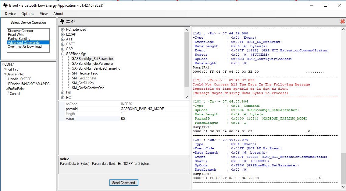

    - Then I tried with another board running HostTest sample program and BTool :
          - At first, I tested BTools and HostTest program with ProjectZero program on the first board.
          - All was Ok and I become a little more familiar with the tool !
          - At next step, I followed the explaination of the Stack User Manuel (Using Privacy in BLE stack)
          - On the first board, I modifies and load SimplePeripheral program as explained.
          - But the problem I encounter is that I  cant set Btool because of an error with GapBondMgr_SetParameter : see picture...
          - I checkd twice, and I really followed all the explainations of the user manual

  • Hello Patrick,
    There is a Bluetooth low energy Security Fundamentals lab here:
    dev.ti.com/.../
    I found some issues when I used BLE3 with BTool. Try to load the BLE5 stack hostTest and use the BLE5 Btool version for testing.
