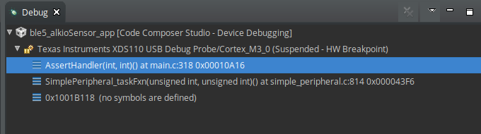

Then, after pausing the debug, i've checked that the void AssertHandler( uint8 assertCause, uint8 assertSubcause) was at a HAL_ASSERT_SPINLOCK. So, i've checked the code at your defines and discovered a HAL_ASSERT_CAUSE_HARDWARE_ERROR (0x08 code) as displayed:
PS: This code is mine... The initial problem was spinning at the "Default:" switch case.

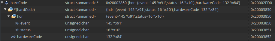

saying how to decode this hardware error, i've got a hardCode with hdr event 0x91 (145) and hardwareCode 0x84 (132) and status 0x10 (16) as displayed:
as said by this document: "A breakpoint can be set in this function to determine the error code. This code should be reported to a TI engineer when experiencing a HCI hardware assert. These error codes are defined in ll_common.h and hci.h."

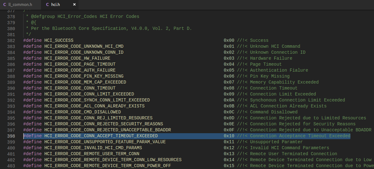

I've also checked those files to see what's hapening, but i found (0x84) as UNKOWN_RF_STATUS (?!?):
and for status (0x10) timeout exceeded. The code 0x91 is not listed at those files - i really don't know if this is correct. I'm confused about how to check this out.

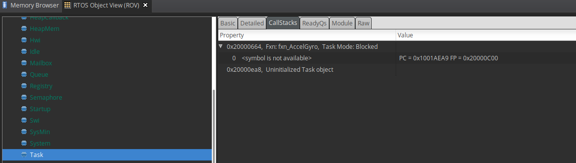

    As you asked, the Call Stack at the HAL_ASSERT_SPINLOCK is:
    It looks like it was using a ROM function.

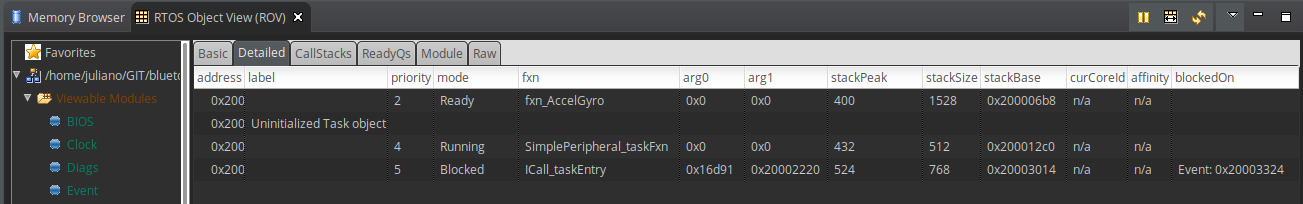

    At the ROV the callstack looks strange (i can't see the Icall or SimplePeripheral task):
    even when, at the BASIC tab, the functions are displayed:

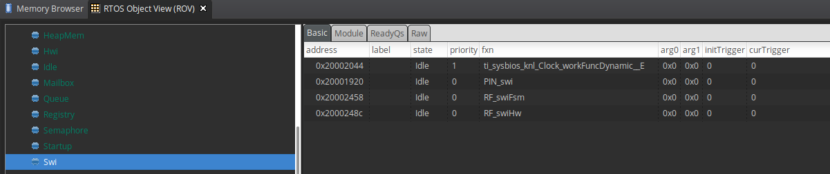

    We discovered here more things that i would like to share... maybe those things help to understand what is happening.
    The HWI shows the UDMA and SPI and also the GPIO ISR (we are using it for a input button isr), and the encryption is disable at this time:
    The GateHWI displayed an exception, but i don't know if it is relevant:
    And the Event shows that the ICall entered in a WAIT_FOREVER timeout:
    The heapmem looks clear at that moment, and without an overflow:
    and the SWI:
