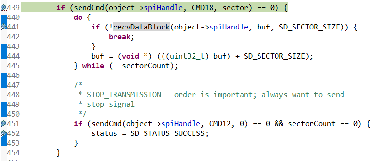

    /* Single block read */
    if (sectorCount == 1) {
    if ((sendCmd(object->spiHandle, CMD17, sector) == 0) &&
    For you CC2640 system, I would assume you use an old TI-RTOS (2.21?) Have you tried to step through the CC2640 code and checked what is done differently in the f_open call?

  • At the moment I'm trying to find out who I should contact with regards to this driver.
  • Th driver team reproduced the issue and looked at the spec some more and it looks like it's a bug in SDSPI. They suggest to try this code block:
        assertCS(hwAttrs);
        if (sendCmd(object->spiHandle, CMD18, sector) == 0) {
            do {
                if (!recvDataBlock(object->spiHandle, buf, SD_SECTOR_SIZE)) {
                    break;
                buf = (void *) (((uint32_t) buf) + SD_SECTOR_SIZE);
            } while (--sectorCount);
             * STOP_TRANSMISSION - order is important; always want to send
             * stop signal
            if (sendCmd(object->spiHandle, CMD12, 0) == 0 && sectorCount == 0) {
                status = SD_STATUS_SUCCESS;
        deassertCS(hwAttrs);
    Please let me know if you manage to use the code/ get the current consumption down.

  • Hi Stephen,
    Yes, I believe you put the code block in the correct place: SDSPI_read(). The idea is to always do a multi-block read (CMD18) instead of a single block read (CMD17). CMD18 involves clocking the SD card for any number of blocks, until you send CMD12 to stop the multi-block read.
    Let me talk you through the debug process I went through. I was able to replicate the high current consumption you experience after calling fopen(). I traced this down to a CMD17 that occurred as part of fopen, after which the current draw jumped to 18 mA and stayed there. I noticed that this high current condition also occur if sending a CMD18 instead, but stops after sending CMD12. It turns out you can also send CMD12 after a CMD17 to stop the high current but you get an 'illegal' command response. So the idea was to change SDSPI to always do a multi-block read so that we always sent a CMD12 that would end the high current condition. That was the plan anyways.
    Did you place the modified SDSPI.c file in a folder (/ti/drivers/sd/) in your CCS project?
    In this local SPSDI, if you could put a breakpoint before and after the sendCmd(...CMD18) I'm interested if you can see the high current start when you send CMD18 and end when you send CMD12. It is possible that this was specific to the SD card controller in my SD card, which would be unfortunate.
    Another thing which worked for me, was to send 0xFF after the CS is deasserted. This worked without changing the CMD17/CMD18 logic as stated above. Change the end of the SDSPI_read function to look like this:
        // Send FF with high CS to go low power
        uint8_t ffByte = 0xFF;
        spiTransfer(object->spiHandle, NULL, &ffByte, 1);
        SemaphoreP_post(object->lockSem);
        return (status);
    Sean
  • Hey Sean,
    Thank you so much for your response. To answer your first question: yes, the SDSPI.c had been removed from the drivers folder and has been imported directly to the project. This was done originally to allow a change in the SPI rate to occur.
    Here are the results from the breakpoint test you requested:
    Line 439: 5.16 mA
    Line 441: 15.15 mA
    Line 451: 15.18 mA
    Line 452: 5.17 mA
    With these breakpoints removed and the program running no decrease in overall current consumption was noted. For reference our code running on our boards with the CC2640 consumed between 1-2mA, compared to our new CC2642R1 boards, which consume between 16-20mA.
    It seems as if somehow the newer code doesn’t let the SD card go into low-power mode. Are there other places in the code that differ between the codebases that would result in the higher SDcard currents?
