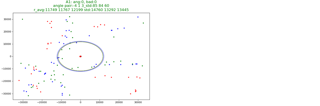

    Moreover, we also observed the distorted sample as following IQ diagram.
     Therefore, we have two issues here.
    1. For ordered samples, the Pab isn't a near fixed value (measured in chamber).
    2. For distorted samples, the iQ data blow up, around 5 to 10% chance. Is there any known cause for this phenomenon.
    It will be nice if you can also check the 2nd issue for us.

    We already have another expert helping you on issue 2 in this post
    so I will leave it to my colleagues.

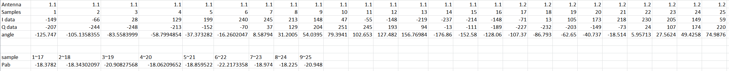

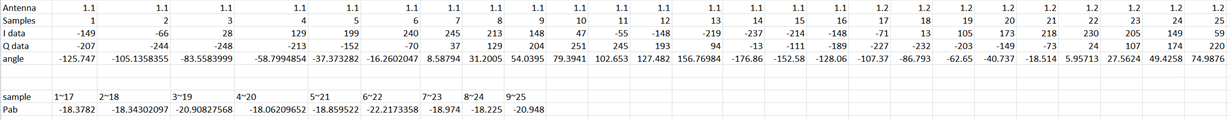

  • Dear Christin
    I use same attached IQ data to calculate following Pab.
    I am using excel ATAN2(I, Q)*180/PI() to get the phase for each sample.
    Is the Pab output data reasonable?

    The first row looks correct to me, however, I have not had time to validate the result from other row. If you can make the data as 1 row I and 1 row Q, then it will be easier for me to validate he data.
    The equation you are using is correct. In which file did you produce the data you posted originally? From the above comment, the first 3 rows of Pab is pretty much within a certain range. Did not spread a lot.
