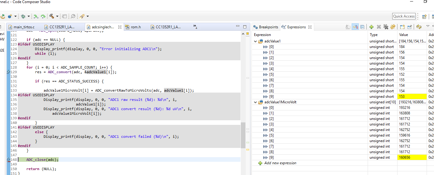

When I run the program I set a break poin at res = AD_convert and set different voltages to the pin DIO_24 (1.75V 1.62V 1.52V 1.43V 1.27V)
But the AD converter reads 184 on the very first measurement, then 152-154, independent on the actual input voltage.
Whats happening here? Might it be a hardware defect? Do I Initialize the AD converter incorrect?

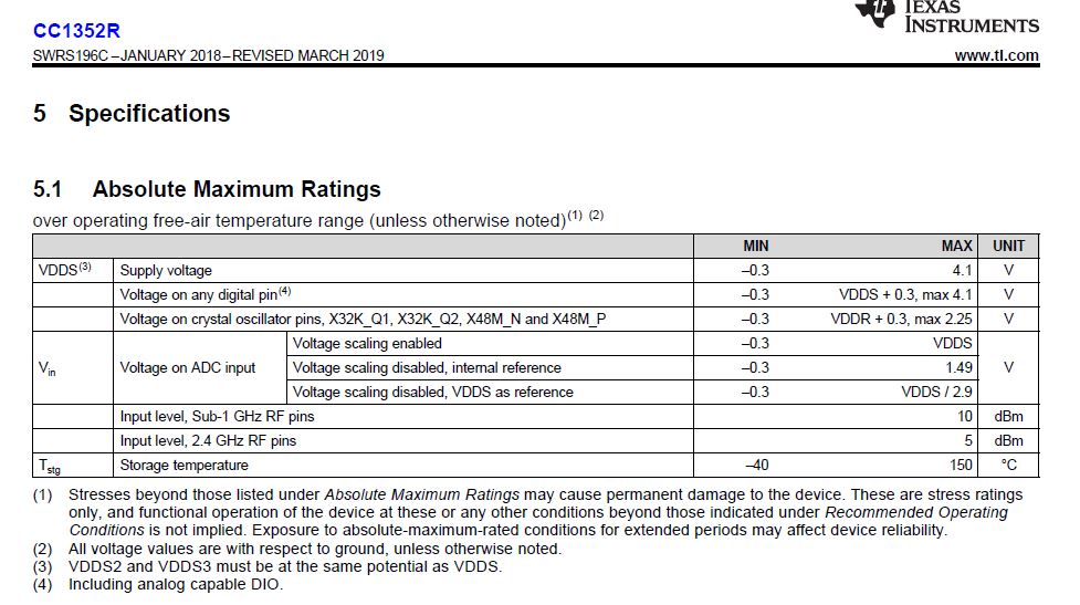

Whats the maximum voltage, the pin can survive? I understand, when I set .inputScalingEnabled it can measure up to 1.4785V. What if input is higher? Would it damage the pin?

        Here are the Absolute maximum ratings of the device.
    In the original example, the readme discussed attaching the ADC to 3.3V and GND to confirm operation.
    You have changed the definition of the CC1352R1_LAUNCHXL_DIO23_ANALOG but you have not updated the definition of the comparator, ADC_COMPB_IN_AUXIO7.  Please note in the original example that IOID_24 went with ADC_COMPB_IN_AUXIO6.
