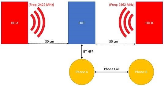

  • Actually our test is to put the DUT under a heavy RF interfered environment, and to see if we hear pops during BT phone call. The environment setup is as below, and the bandwidth of two WiFi AP is both 40MHz, as the result that WiFi 2.4G covers all BT channels:
    The packet error rate is this case is very high, is this a case that PLS can not completely eliminate pops?
  • Will,
    Yes. The eSCO connection typically has re-transmission efforts negotiated between the two devices. If for some reason an eSCO frame cannot be received by the WL18xx, for example due to intermittent RF interference on some of the BT channels, the PLC algorithm will try to estimate the missing frame from other valid frames to reduce the pop noise on the final PCM output. However, if there is strong RF interference on all BT channels all the time, the PLC will not be much effective. As you mentioned, the packet error rate would be very high in this type of environment and PLC would not have enough valid eSCO packets to estimate the missing packets. In this case the pop noise are inevitable even though the PLC is working, since there are so many eSCO frames dropped.
